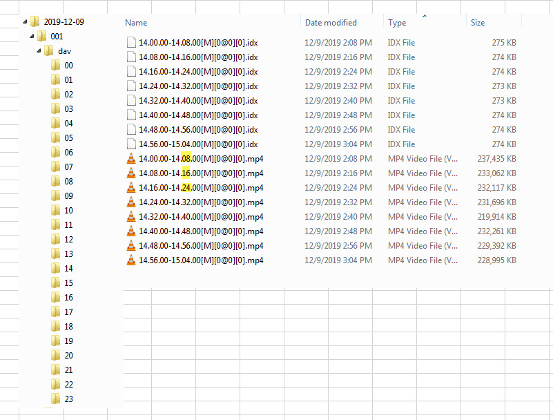

Just wanted to show you guys my 12/09/19 recordings. You can see each mp4 is an 8-minute segment.

Re: Amcrest IP8M-2496EW - Recording Question
Yes that is how my FTP looks as well. The good thing and odd thing is your times are right so it seems where mine has been wrong for long time... However looking at the files tonight they are all within the Right Time LOL Meaning the times on the right never matched the times on the left lol However after my Last Purge lol The times are right that is strange... Sadly My Cameras are still Changing the Time format on the camera even after I have set up the time to be 12hr and M, D, Y within a few days it is back to 24hr and date back Y, M, D lol Drives me nuts....

Jack7:
When I was reviewing my videos everyday for two weeks, I kept saying "This makes no sense".
I kept asking myself "What is it that is triggering the 24x7 recording?". If I have mp4 files from
00:00 to 23:59, then everything is being captured. I can tell you what's happening at every minute
and every second. You said something must be detected (ie movement), well I have reviewed many
mp4 files, I can tell you nothing was moving including the late night ones and when days were calm and no
wind at all. Yet it produced these files.
Now one thing I didn't mention in these posts is, for the JPG files, not everything is being
captured and there are a lot of gaps. Example, I see my mailman driving his delivery truck in mp4 but not
in the JPG files. Again my T/S settings are 90/5 respectively just like my other IP2M-841's.
So if we are saying the reason for 24x7 recording is because of the camera settings and this outdoor camera
doesn't do 24x7 by default or by design, then why I have so many gaps in time for the snapshots? Example, everyday I exit my front door and walk to my car on my driveway, I have found NO snapshots of me. Obviously there's HUGE movement here. But why no snapshots?
My other IP2M-841's inside the outside, they seem to be working to my expectations. These don't record 24x7. Yes, there are LOTS of movements inside the house but they don't record 24x7 which is what I expected.
Here's another weird thing about those 8-minute segment mp4 files. Why precisely 8 minutes? It can't be
movements. That I can tell you. Nothing moves during the wee hours. I live in a cul de sac inside a very quiet development.
8 minutes is what you have set as record size in Record.
I doubt the snapshots are causing the 24/7.
While it's recording 24/7, go to Event- Detection Area and see if any squares are lighting up in the image and there's activity in the graph on the right. If not, there is no detected motion going on. Adjust sensitivity and threshold there to see what happens.
