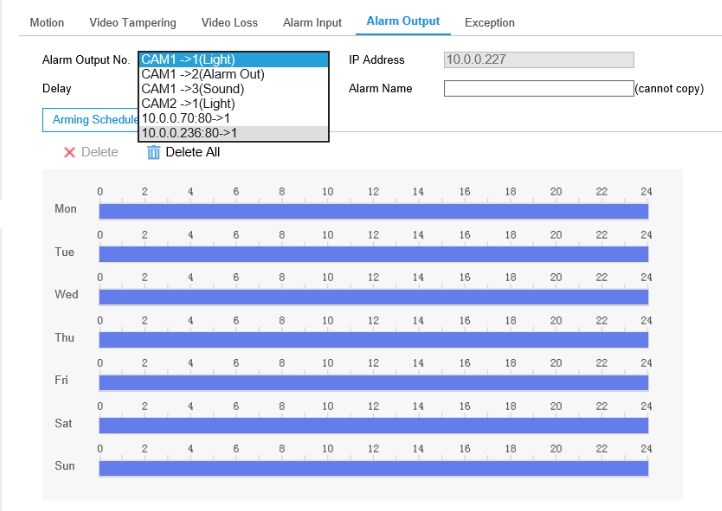

So here is just a fast Demo. I took some hardware and moved it around to work with a couple of cameras and where I could make a Video without upsetting my neighbors from Loud Audio.. Maybe this will help understand what and why I am trying to make this happen at a DVR/NVR level..

However here is a picture of my system with the Alarm linkage. I did install one of my 850 and my 4mp AI pro camera both having a Alarm output so you can see here in the picture them IP addresses for the added cameras and camera 1 with Light, Siren, and Alarm output along with camera 2 that has alarm linkage to a Light output. So that is what I would like to be able to do is (USING Amcrest NVR link to either Preset that is hard coded to the Audio Alarms or having the Audio Alarms with a link to them from another camera on the NVR)
Like aside from the Alarm linkage here, I could using the Built in Preset from my camera that is showing on A1 just use Preset 110 and it will make all 3 of the alarms in that camera go off..
https://imgur.com/a/DrOw2B9
