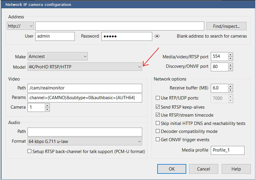

Re: upgraded IP2M-853E now hae no control in Blue Iris
So I am not sure if this will work but thought I would pass it along and see if it helps and I hope it does... I think you might have to try adding it again to BI and use these settings...
yep, tried that one before and again just after I saw this - just to be sure.
No Joy.
