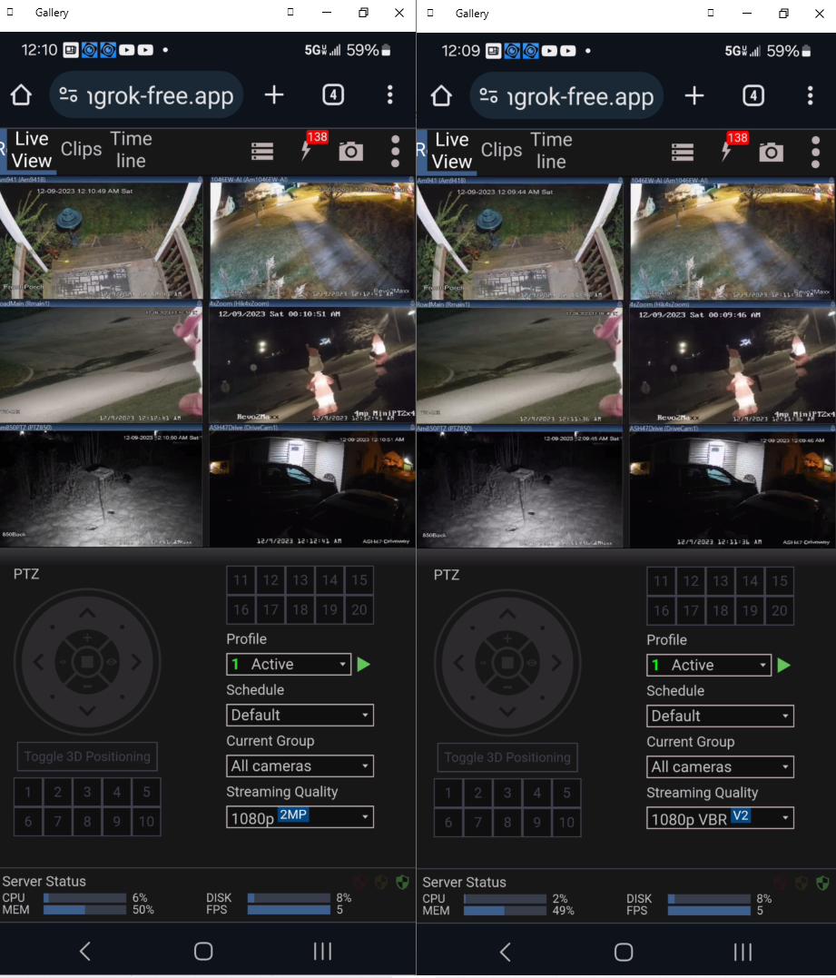

So I setup a Tunnel to have access to my Blue Iris and the quality if kind of low. Anyone using a tunnel service to access the Blue Iris that might have some insight why the feed looks so blurry?
So I click on my Webserver page that connects using a tunnel service that I setup. I have 100mb download and 20mb up so there should be enough speed to look over my current setup of 6 cameras without it being so blurry.
Thanks in Advance.
Re: Remote access
So I don't know if there is a different way to start the feed. However I found that the issue might be related to the connection starting out in a VBR 1080. If I change to the 1080P format in the listing or anything that don't have VBR next to it the feed is no longer blurry and looks nice. So not something that I would use often. However because of the idea that Bi is like a DVR/NVR and I want to have access to my feeds from outside of my home like I do on my DVR/NVR's that I have not only bought the BI App I have setup Remote access to my Blue Iris. This way I have more info about these features and able to offer some help if the need ever comes about.
So yeah. It always starts in 1080P VBR setting. I change to 1080P and it looks just fine..

No it wasn't a connection over the UI. I was remote to my Network and used a browser to connect to my BI using a link with my WAN Ip address. So it might have been the connected network as I didn't think about doing a speed test at the remote location at the time. I have tested the connection a few times a day right now showing some friends how easy it is to connect using BI remotely. My guess is that is how it is setup and if wanted better connection just make the change out of VBR view. I don't normally push BI but have a few friends that are in need of some Extra AI and wants access to that while away form the connected location. So after seeing how I had my BI setup with the cameras and what it was able to do they wanted BI but only if I would help them be able to connect remotely. So I was sure looking over the software it was easy to setup a remote connection so I went to show and help install BI.
Also just testing from my cellphone I will admit that even in VBR mode it looked almost just as good as it does when I move over to normal 1080p 2MP See the picture below. You can see that the Cellphone is connected using 5G and not my local wireless. Took the 2 images and made into 1 seeing it was easier to do so.
Screenshot (779).png (811.81 KiB) Viewed 18035 times

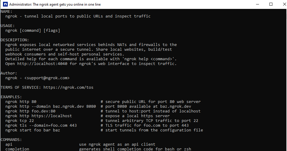

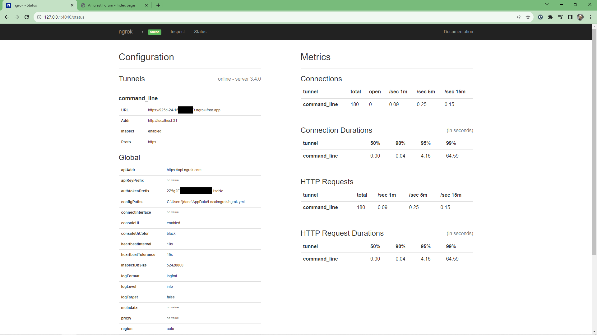

Re: Remote access
Interesting, I just use the one that BI had in the software already seeing it was there I thought sure why not lol. Interesting no one talked about it. NGROK. Free option is what I am using for BI at this time. However I have some ideas that I might be going to a pay account before long. Only thing that seems to fail for BI connection is UI3serviceworker.js all other have passing good connection. So kind of cool with options even the free service has. Picture below shows some info about the program. I turned it off brought back up before running starting command so I could show info that isn't showing when the system is running..
Screenshot (783).png (41.26 KiB) Viewed 17904 times

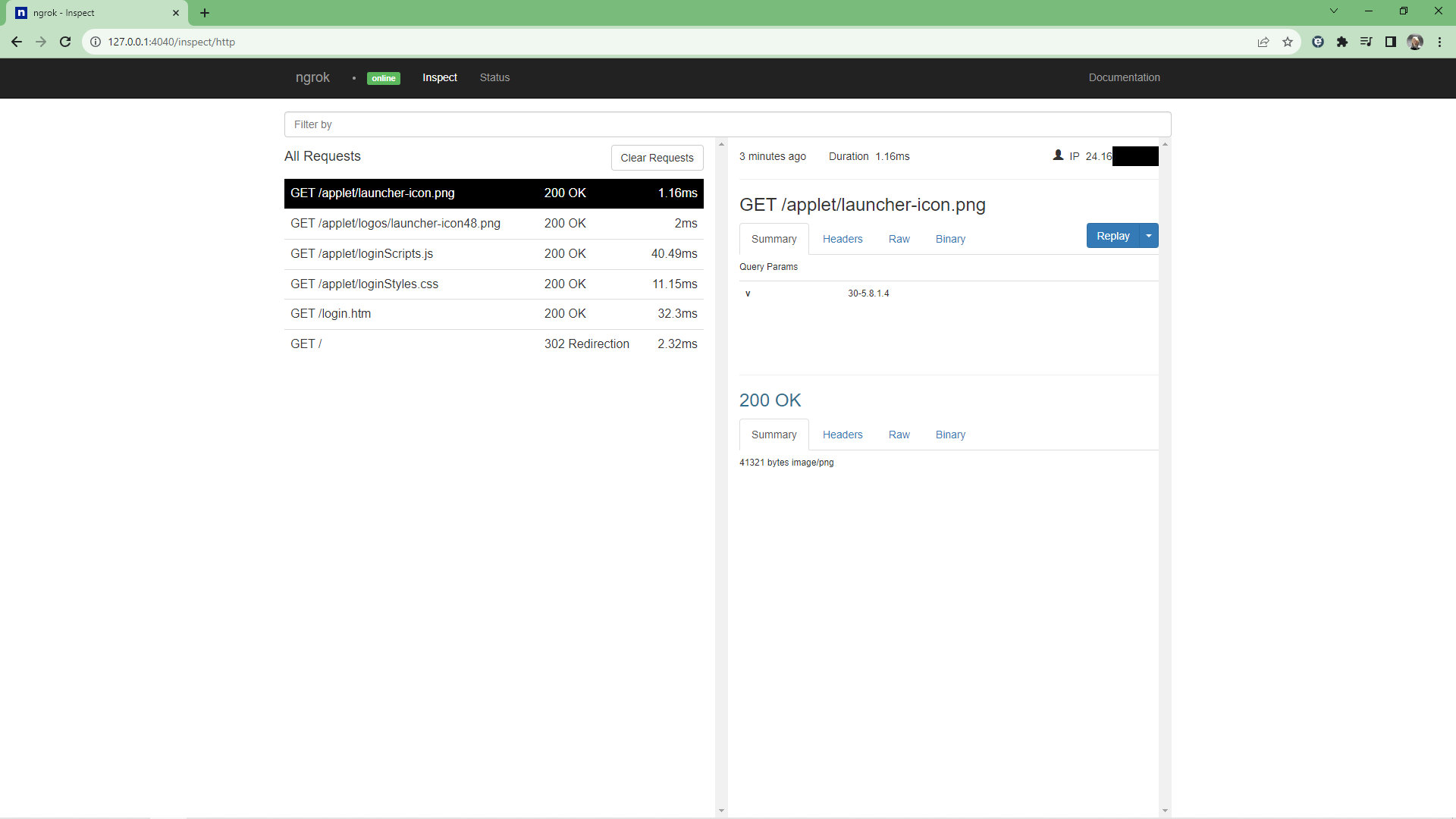

Re: Remote access
here is a little webpage of the server that has log tracking and info that can be helpful.
Screenshot (784).png (65.44 KiB) Viewed 17901 times

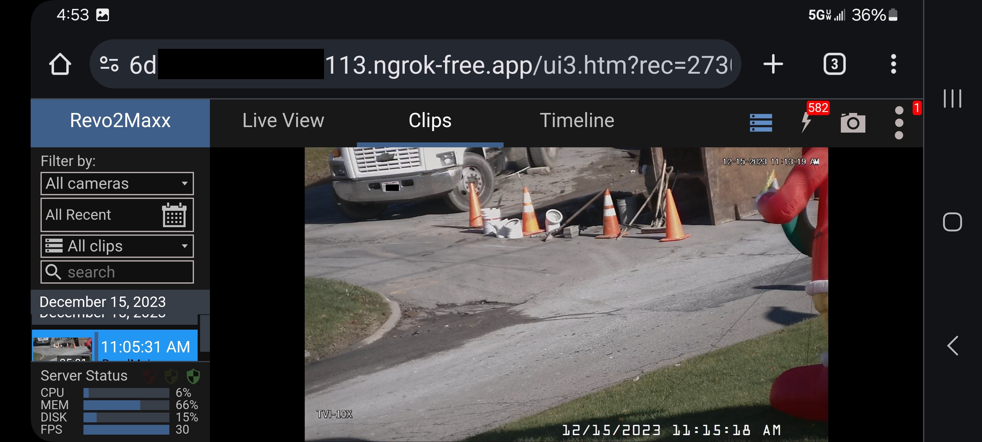

Re: Remote access
So I thought I would post this. It was from yesterday having some work done on my street and this was the playback from my Phone. While I was local to my network I have the Wifi turned off and this is accessed using my Cell 5G internet. I have used this a few different times showing friends how easy it is to access the Blue Iris Server remote. Even showing them from their own Internet on PC and Mac.
The service that was offered in my Bi was NGROK and it seems to work great. There might be better tunnel services out there, This one is free and works.
Only thing I took out was the address and the Lic Plate number of the dump truck. The rest is just how it was displayed even showing 2 dates because I guess the way the screen was positioned. Playback was smooth and I will admit that there are times in this version of Bi (Current updated) when in playback and if there is an event that happens when a car goes by the CPU does go to 100% I have only had it crash Bi once so far. That could be because there is other things that are running in the background. I still have not moved the AI server to another PC. As soon as I get a new cooler for one of my other higher end PC's I will do that.
