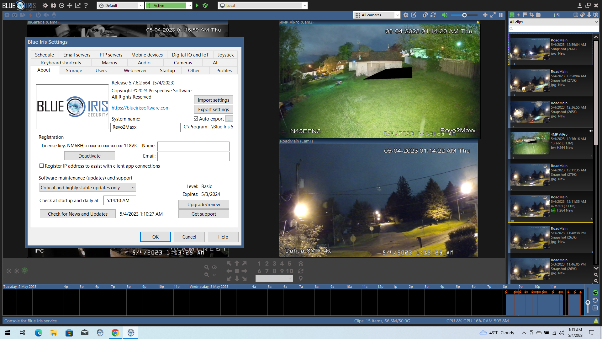

So yeah there is some missing info from this install. I think I might have to re install it or do something to make all packages that I have installed to work. It might be because my Computer keeps doing Windows Updates. So after a few days of being online and tweaking some things I will get a better idea of what is missing and what needs to be removed and added back. Also oddly all cameras that I have installed with Amcrest Format even Dahua format has been changed to Generic lol.. I mean good news is the PTZ works on the cameras that are PTZ so that is good. Can't seem to find the custom models that are from the AI even though I have installed them.

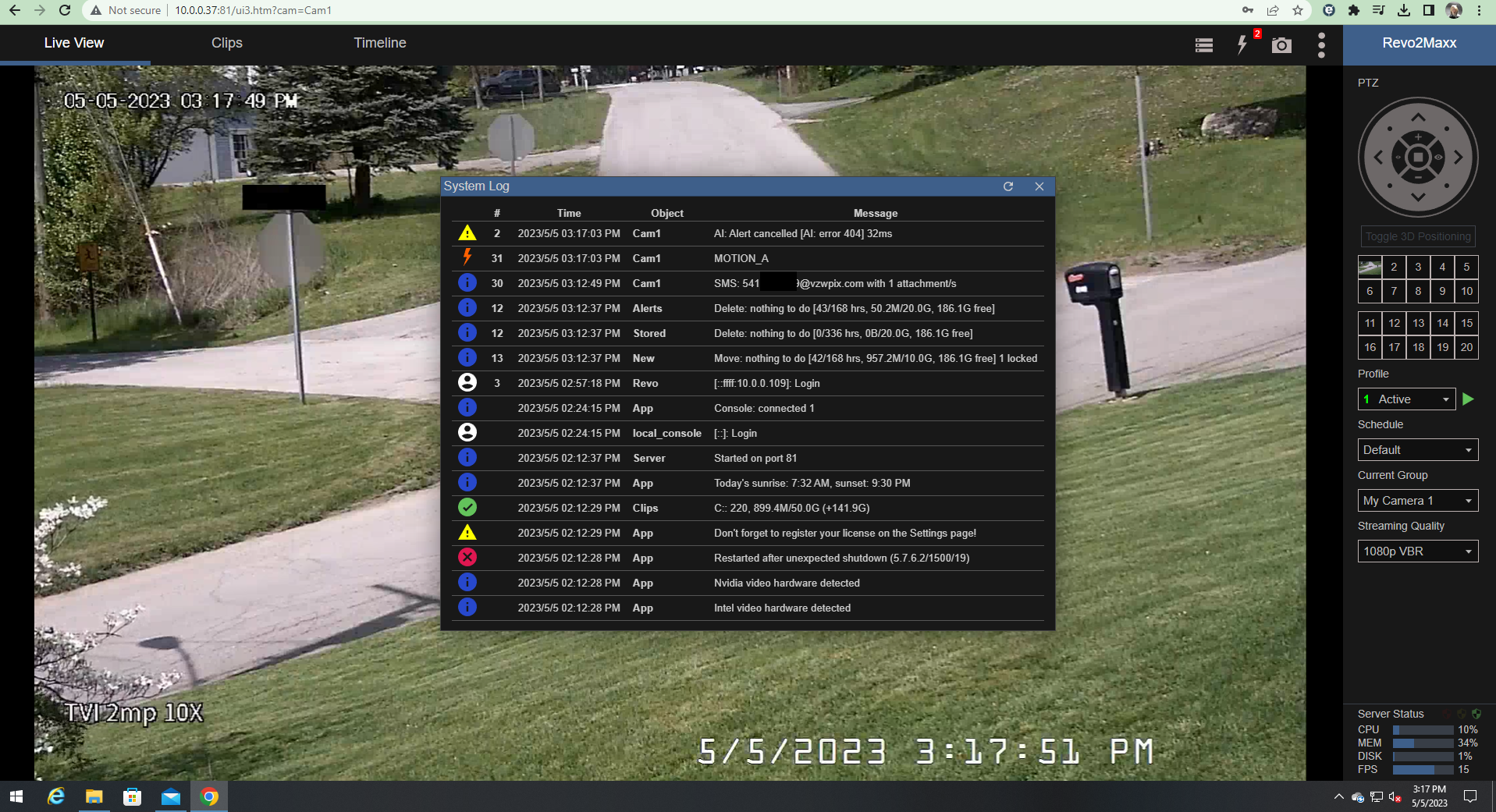

So Last night after removing all my cameras and setup just 1 and setup for SMS messages you can see in the Log here that I was able to get SMS however that was after going all night without one message. I remove the AI module from being setup and I get motion only alerts without an issue. However I Re-install the AI mods and even though looking in the AI server info says they are running looking in the logs they errored and are really not running even though the server says they are..
I removed them all. Installed them all this time trying to without my GPU as a factor and still errors for no reason.
