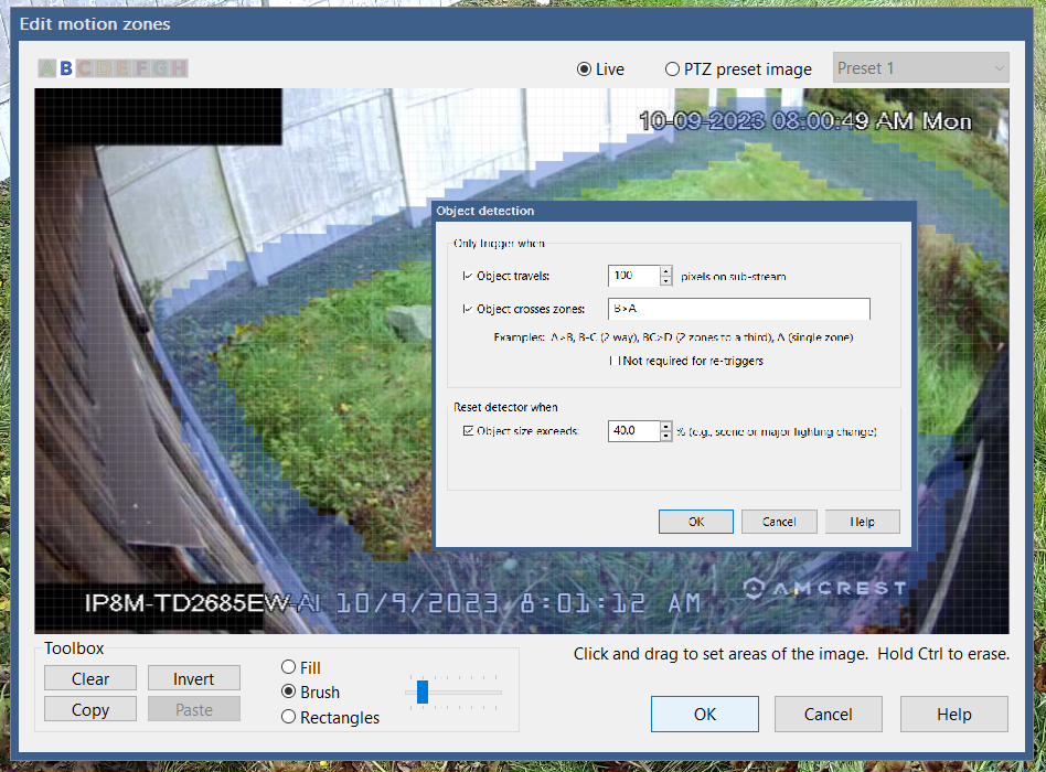

Then there is also another way to do it. This is setup in a different area and different type of settings altogether. That is in the Trigger area again. This time under motion sensor. then under advanced, click on Use Zones and hotspots, then setup some motion zones for your ROI, Lets say you have a fence that is where the dogs are coming from you want to trigger when the dog comes under or over that fence, So you make that zone let say A then make the rest of the zone b. Save that part and again under Advanced click on Object Detection, Then click on Object crosses zones. Then choose what you have the zone setup from what to what and save. When that happens it will trigger an alert and record. However because you have it setup from A to B if your cats go the other way there won't be a trigger event..

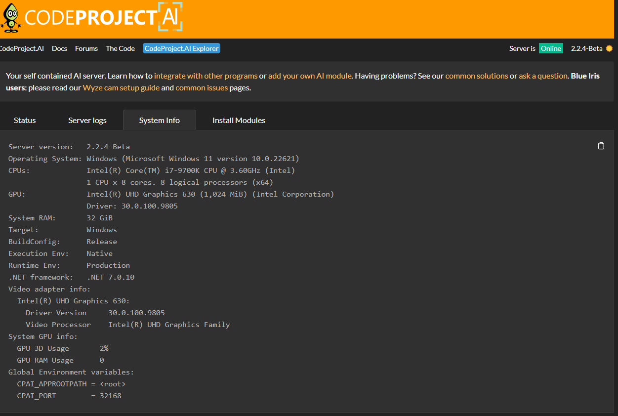

Remember my DVR is the AMDVTENL16-h5.

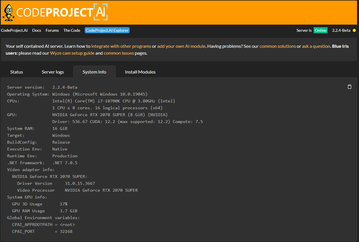

Your system is better then the one I am running Bi On. However here is the stats from my Bi and CodeProjectAI Server info. Also you can choose to setup the AI server on a Different computer. I might be doing this before long to see if it might help seeing I have enough computers to do so..

Just starting off, is the GPU that important? I'm broke remember? So if you have the time, how can I incorp this into BI or what?

No you don't have to have GPU to run it, in fact I have turned off GPU for LP reading as my CPU is better at it. However for the rest I have the GPU working as it will.

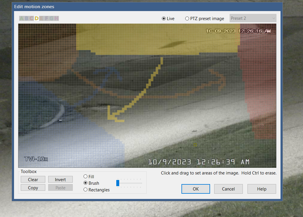

So in the motion detection area, This isn't 100% how it is setup I am just showing what I am talking about here in the Grid area. On what you can do, However with the zones connected in the center you can setup things like I have the Arrows pointing. The you can setup for it to do different things for different crossing.. But in your case.. Your trying to connect something to detect an intrusion into your property . So take zone at your fence or area of interest of where the dogs cross into the property, and the area inside making it a different zone then telling the Bi what you want to do. You might have to also adjust for smaller detection size to capture the dogs or other animal you don't want entering your yard.

So for a better idea what what I meant for your type of setup.. Here is a look at my 8mp AI camera in the back. 2 zones and setup if something goes from B to A it should trigger..
