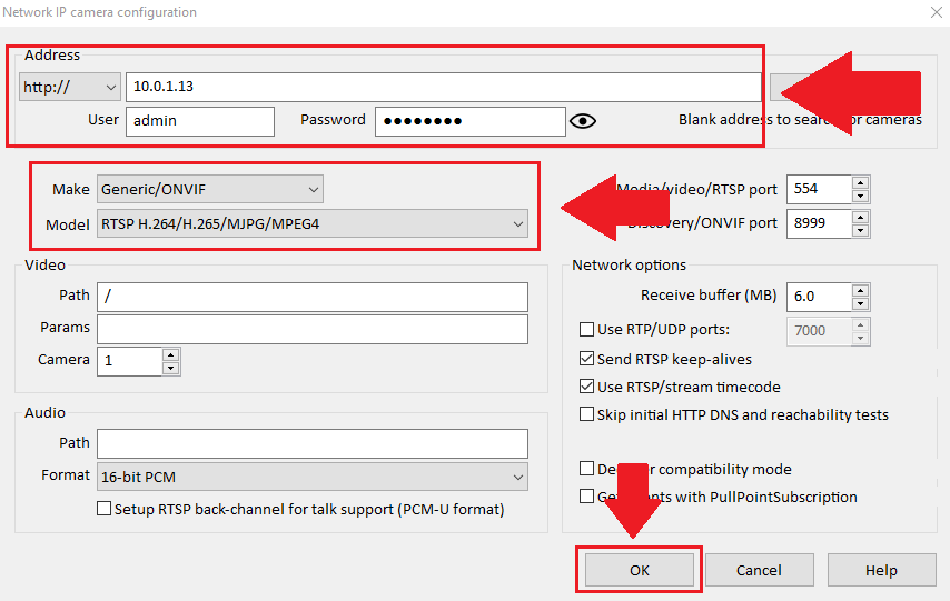

I have a Blue Iris security system with 8 cameras, 2 of which are Amcrest --no problem--. I have not been able to make the AD110 work with Blue Iris. I used the password that I established, but I am not sure about the user name. I know that Amcrest is fixated with "admin", but I recall during setup that it asked for a user name and all I can remember is that I entered my email. I am sure it is not using that, but during this doorbell setup I don't remember it confirming the admin user name. That may be the problem. I am asking...
Has anyone successfully set up the AD110 in Blue Iris? Amcrest has a link that shows the setup procedure and I followed it to the letter and I am getting a blank screen in Blue Iris. No problem with the other apps.

There is no Web UI for AD110. Only use Amcrest Smart Home app to change AD110 settigs. Trying to use any other software to change AD110 settings could destroy the camera.
Blue Iris setup: https://support.amcrest.com/hc/en-us/ar ... -Blue-Iris

@Sammy, the ad110 doorbell does not have a web GUI. you connect the doorbell in blue iris via rtsp.

ip address is doorbell's ip assigned at your home network. you can make a dhcp reservation for your doorbell from your home network router with the doorbell's mac id if you have not done so. the password is your doorbell's password; not the password to the smart home app. you will need to start over from scratch if you have forgotten the doorbell's password.

Hmm. I thought it was natively on port 80 which shouldn't need port forwarding. Is it actually port 8999?
I'l give that a whirl. Nice that their instructions don't mention this but I should have caught it myself.
