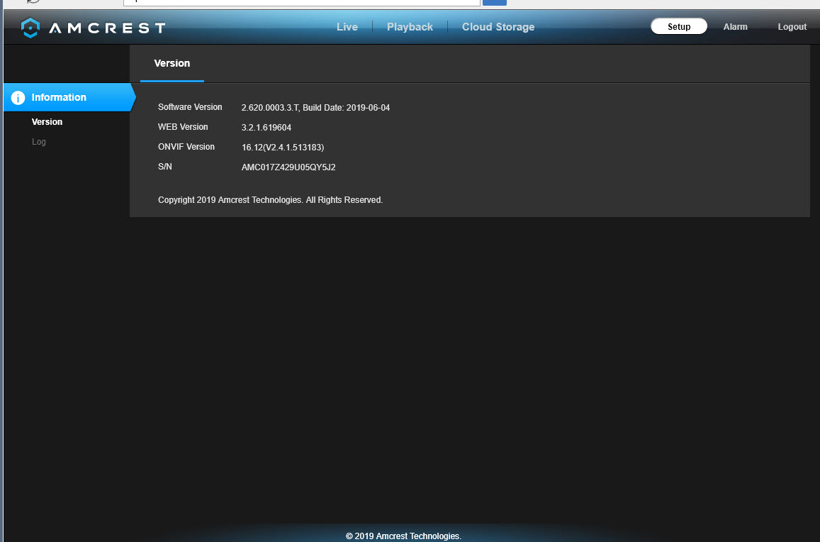

I updated the firmware to the Betaversion on my IP3M-941 and now I have no PTZ and no ability to configure or setup anything on the camera. I can view live stream and get to the playback tab but nothing much else. When I click on the Setup tab/button, I only get version information and log. I just wanted emails to start working again but I guess this camera junk now. I'm not sure how I can reflash the firmware back to the stable version. :(

I know it's Beta and things can happen. I did let the firmware upgrade complete on its own. Anyways, is there an alternate way to put the stable firmware back onto the camera? When I click on Setup on the camera, I don't get any of the configuration options. I only get "Information" and "Log". I attached a screenshot.

See if anonymous login got checked.

Post by Schweinmesser »
Thanks for the help. I was able to resolve. I logged in using another admin account which had all the settings. Anonymous login was not checked for the affected account. I then removed the affected admin account and then re-added it back in. The account works as expected now. It seems to have been a "feature" of the firmware upgrade.
