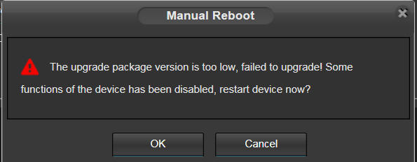

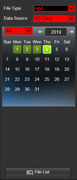

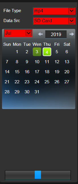

I was not able to download the recorded clips from the SD card on 2496 model when using Internet Explorer. So I did the firmware upgrade. Now I dont get the list of files on the right side to select them to play back. If I press the button below (like the Back or File button in old version) the new version goes to the batch download. That button is not named. It is just a grayish bar with a bluish box in the middle. Also it looks like the 4K camera records dav files and not mp4 files.
I tried going back to the stable version. Then it says version is too low and did not revert to that stable version. Now I cant even go back to the old version. Without a way to play back the files or down load them like the 4MP camera, this 4K camera is useless for me.

Here are the images of the right side menu in the new and old versions. As you can see the File List option is not shown in the new version. There is a bluish button and if I click that button, it goes to batch download. I dont get the file list where I can double click a file to play back and also click the download arrow to download the file to my PC. Both the options are gone.
