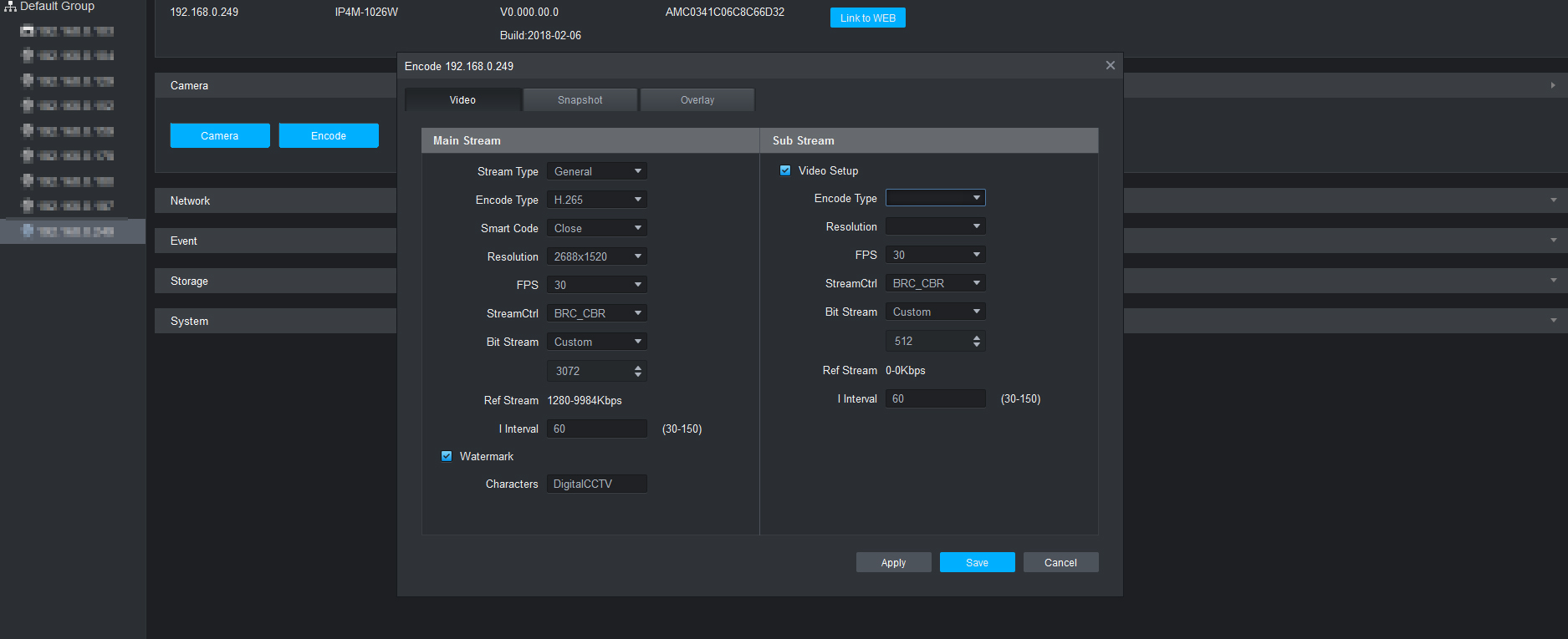

I can access the camera 3 ways (Amcrest Pro "PC app", Config Tool, and WebUI/IP), and I've noticed it's not consisant... (screens below)
Via the "App" and Config Tool it all seems the same...
ASP screen 1.jpg (314.99 KiB) Viewed 2283 times

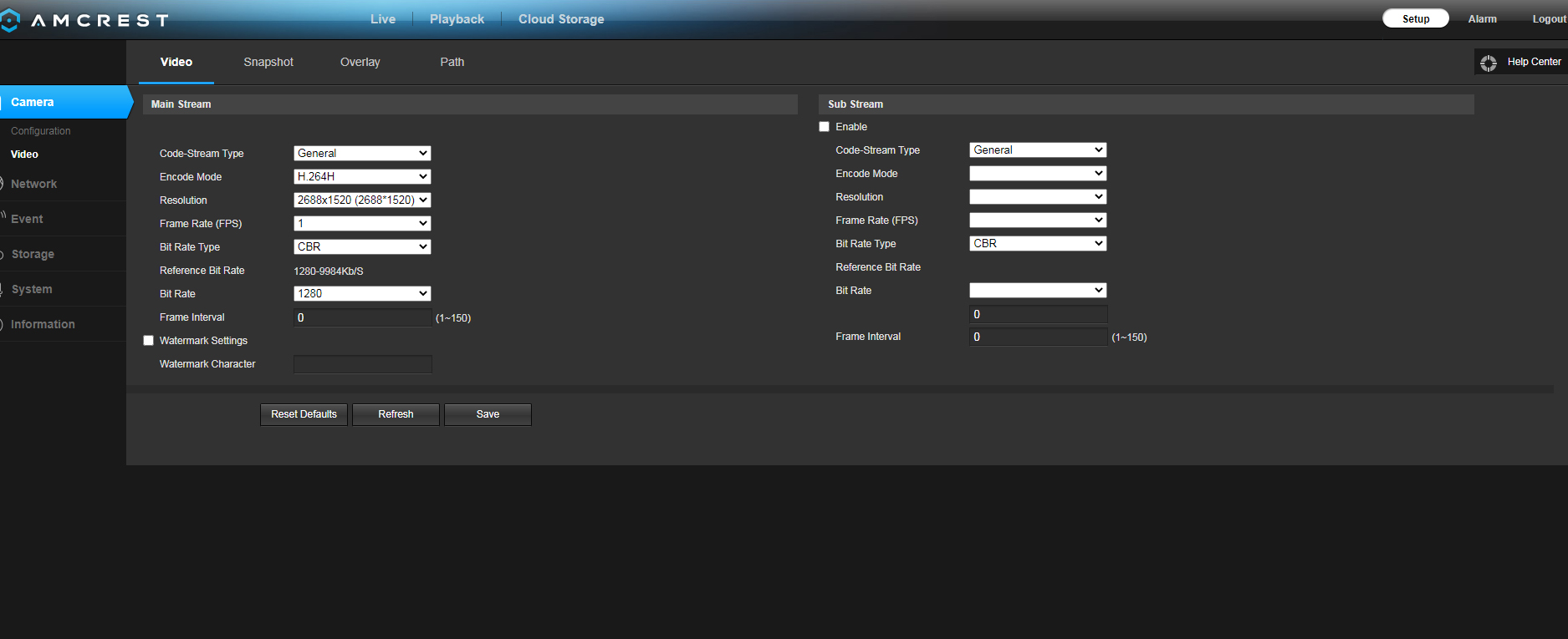

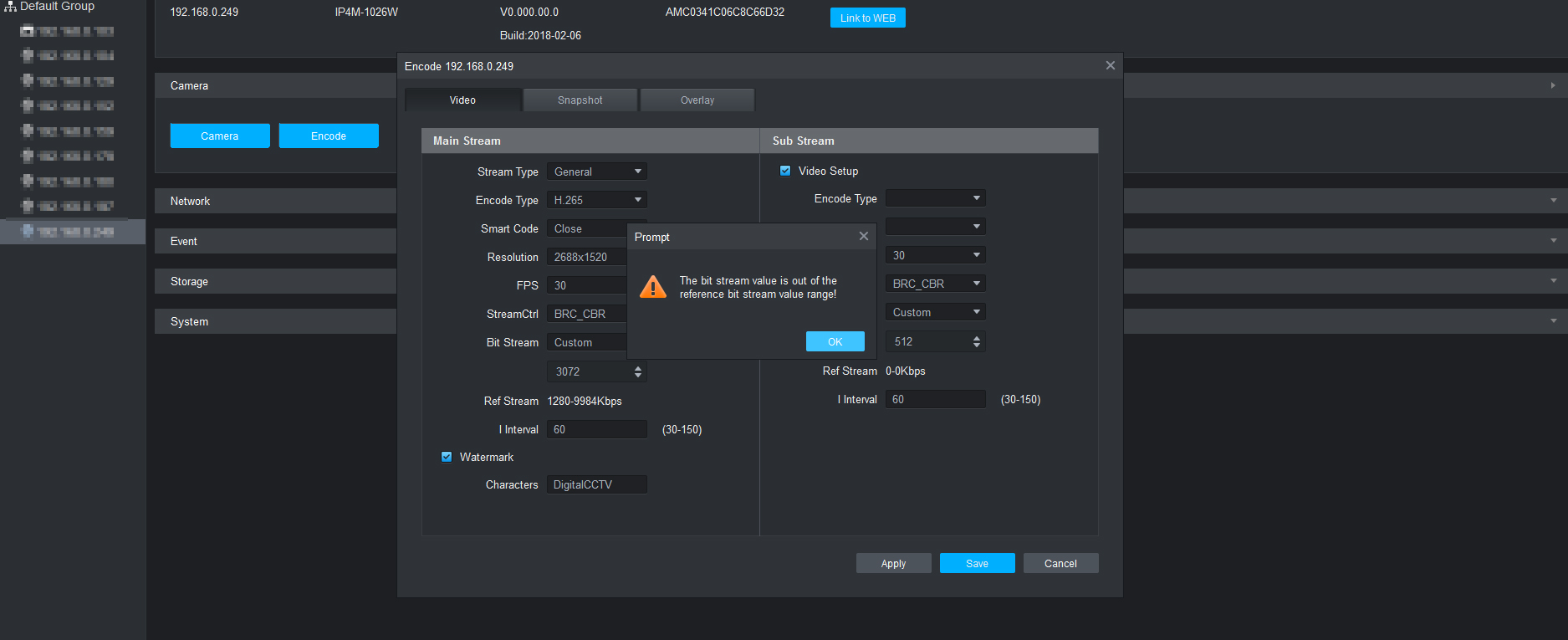

Unless I try to save a change, or sav without changing anything, I get this... (the bit stream is THE SAME as the other 7 working cameras)
ASP screen 2.jpg (325.37 KiB) Viewed 2283 times

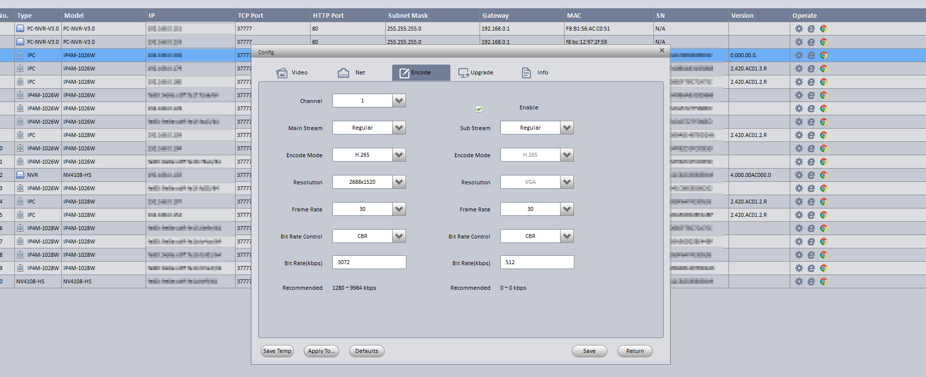

Setup screen via Config Tool for comparison...
Config Tool.jpg (589.67 KiB) Viewed 2283 times

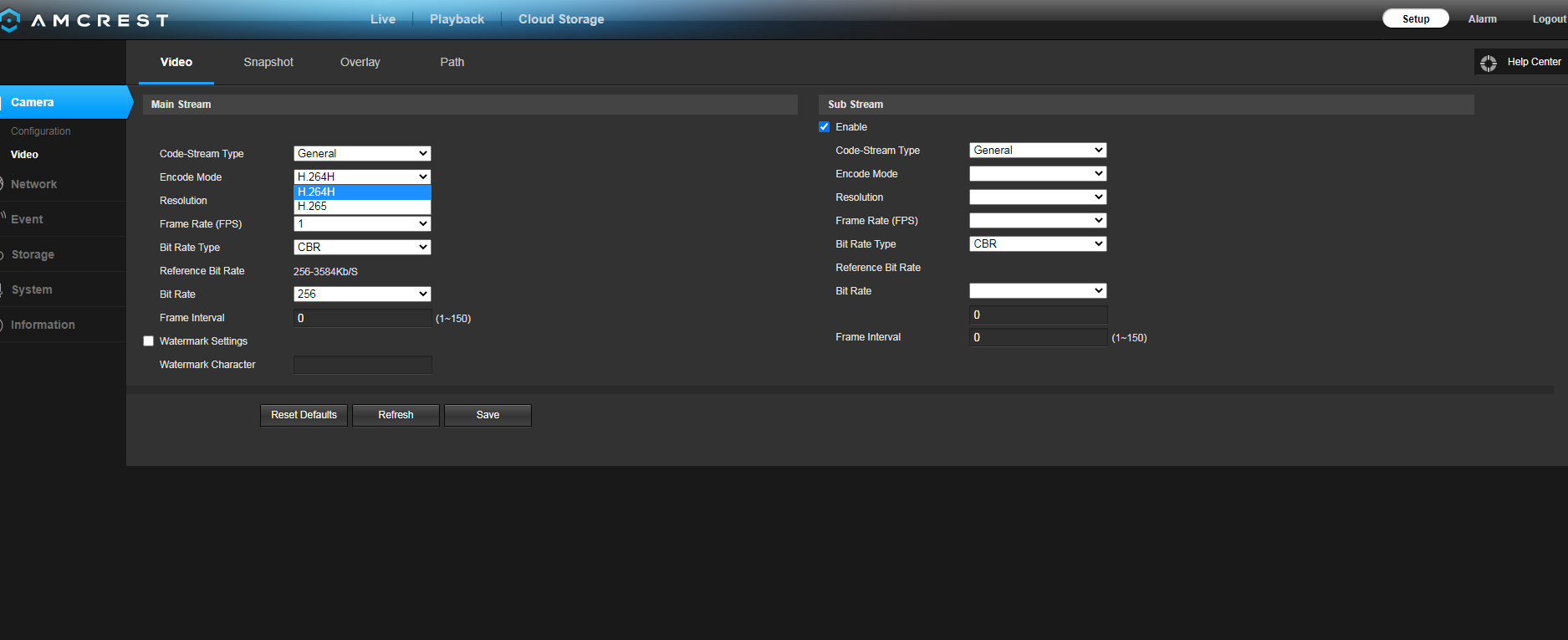

Via the WebUI/IP login however, the settings look different than the rest... (Encode mode shows 264 instead of 265 like the others and sub stream is NOT enabled)
WebIP screen 1.jpg (295.61 KiB) Viewed 2282 times
I can pick a few things from the dropdowns for the main stream (subs are blank), but regardless of what I select it reverts to what it was before instantly...
WebIP screen 2.jpg (293.72 KiB) Viewed 2282 times
I can click enable for the sub stream and hit save, but then it just "resets" again anyway. It's as if I can see everything, but can modify anything at all.
