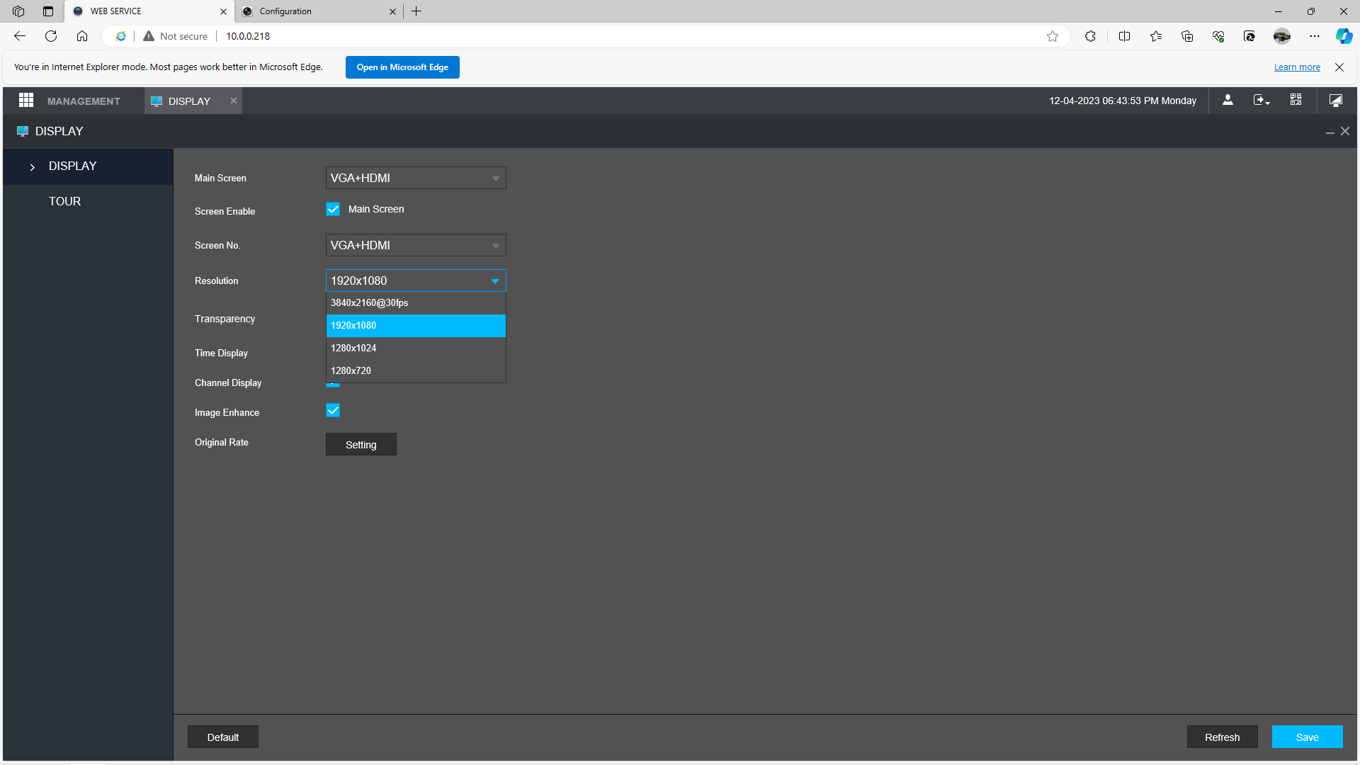

So Here is what I would try, I would remove all the cables if you have more then 1 connected, where the only left is the Power cable. Once this is done power cycle the monitor and then try the button close to the power button holding for 4 or 5 seconds. This should unlock the monitor. Once unlocked press button again to open Menu? If it only brings up a black page then I would look at an RMA if it is within a Warranty time frame. If not it might need to be seen by a TV repair company. At times they can have hardware to do a Brute Device Reset.
outside of that the NVR would be best used connected to a TV or Monitor for best access. If you are trying to reset back the NVR to work in 1080P format you can do so just by having the NVR connected to the local area network and going to the NVR's Local IP in your web browser, Then you will want to go to The Configuration (Setup) and then display. In there you can make a change to going back to 1080P. That page would look something like this.
