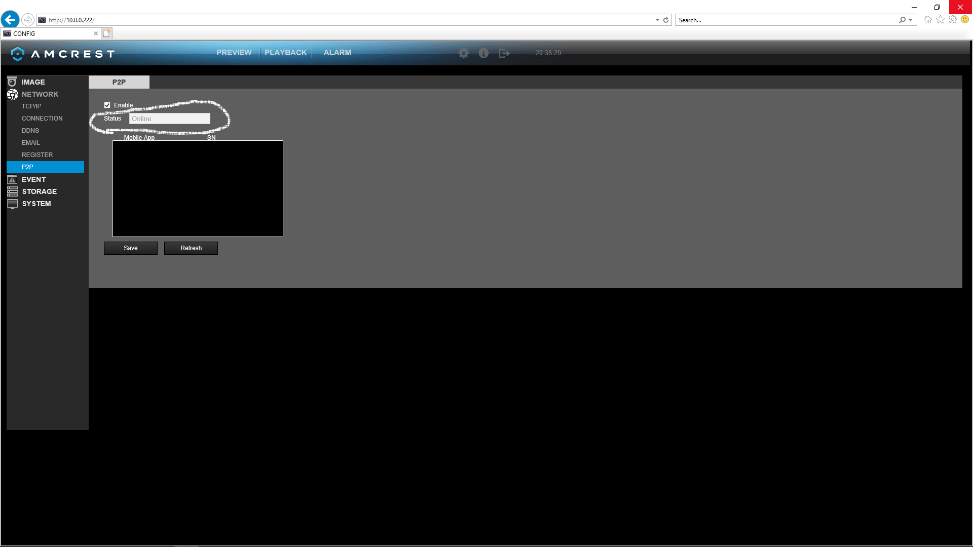

okay so i am stuck in the p2p.. it is enabled but status is offline
Re: Unable to connect remotely
So this are that I have marked on your camera or NVR says it is offline?

Revo2Maxx wrote: ↑Sun Aug 09, 2020 8:03 pm So this are that I have marked on your camera or NVR says it is offline?
correct

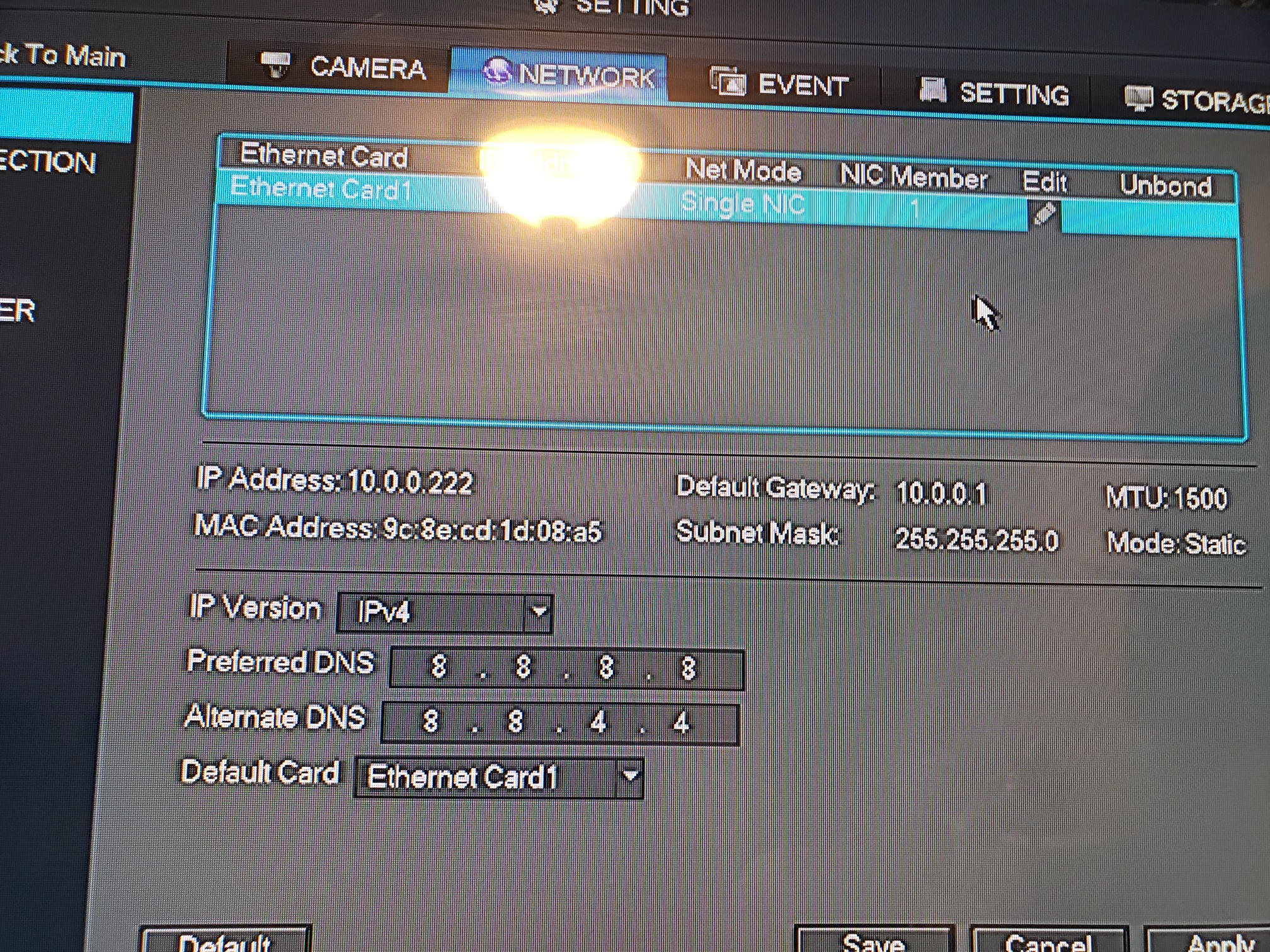

I am going to guess that and I hate to say it but it sounds like you have a Network issue.. Click on your NVR, for menu then click Network on the settings area, then under the TCP/IP is your system set with a Static IP or a DHCP?
IF Static I would do a couple of things.. First replace the Network cabling going to your NVR from your Router
Second I would double check in that menu there and make sure that your typing in the Right IP address...
third by the way it does take little time to compile the data that it will then put into a text file format for your reading..
If your NVR is setup for DHCP and not static you will want to click on the little Pencil and change that to a Static setting... This way it will always have that same NETWORK IP.. Like I have to bring up my Router now days to see most of mine seeing I can't remember things to well anymore and it don't help that I didn't keep them uniform.. Like I have some at 150, 159, 165, 222, 223 and some others that I don't visit often enough to remember lol.. Then the IP cameras on top of that isn't easy to remember at times I have to look at the NVR or Dvr to get the ip for it lol..
Anyway this picture is of my 4k NVR sorry about the light in the backgound but took picture in hurry didn't turn off the light.. Looking at the picture and should be same in yours as well it is on the center bottom right if it is Static.. May need to reduce your MTU but 1500 is a good spot most times however I have seen some that needed to be lowered to make Network work right..
