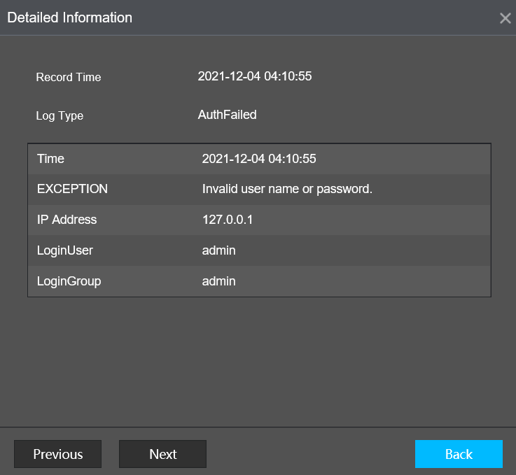

Now on P2P there is only 1 thing I don't like when it comes to logging the wrong pass lock out. It does with the NVR's local Host ip of 127.0.0.1. However when someone is on the Web it will show the Connected IP of the person from the web. Over P2P it will log the Invalid name or password but show the local host IP. See picture below.

So lets say that you were logging in on your phone for the first time and put in the pass wrong. When it connects and test that pass it will know that it was wrong and fail. Now looking at the data it does show for user even though it isn't in plain txt it is the same each time unless you using a different user name the pass is different each attempt to connect. Looking at the data for wrong pass it still sends out info different each time. Looking at the incoming data goes out one Port in a different and pass data is just a key if the return key is on the wrong port or wrong key is returned then no connection. Have mine setup for 5 fails seeing that is the lowest I could set it for and locks out for 120min max time I could set it for.
