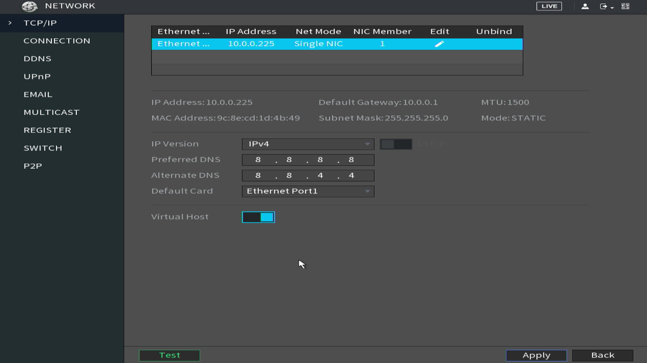

Another thing I just noticed after I hooked a monitor to my nvr.
in the Network TCP/IP it show nothing for Ethernet card? Should it show the nvr ip here?
Re: Push Notifications
I have let them know from my contact point. I would still maybe do a Ticket if your still having issues. Maybe it would be faster to get it from a Ticket Source.
About your NVR yes it should have the info in there. If your talking about this window in the picture below...
Screenshot (1812).png (158.3 KiB) Viewed 4371 times

Mine had nothing there, did a factory network reset and it came back. Just checked again and it blank again? If I open web connect from Amcrest Surveillance Pro its shows up there. Not sure why a monitor on the nvr shows nothing.
