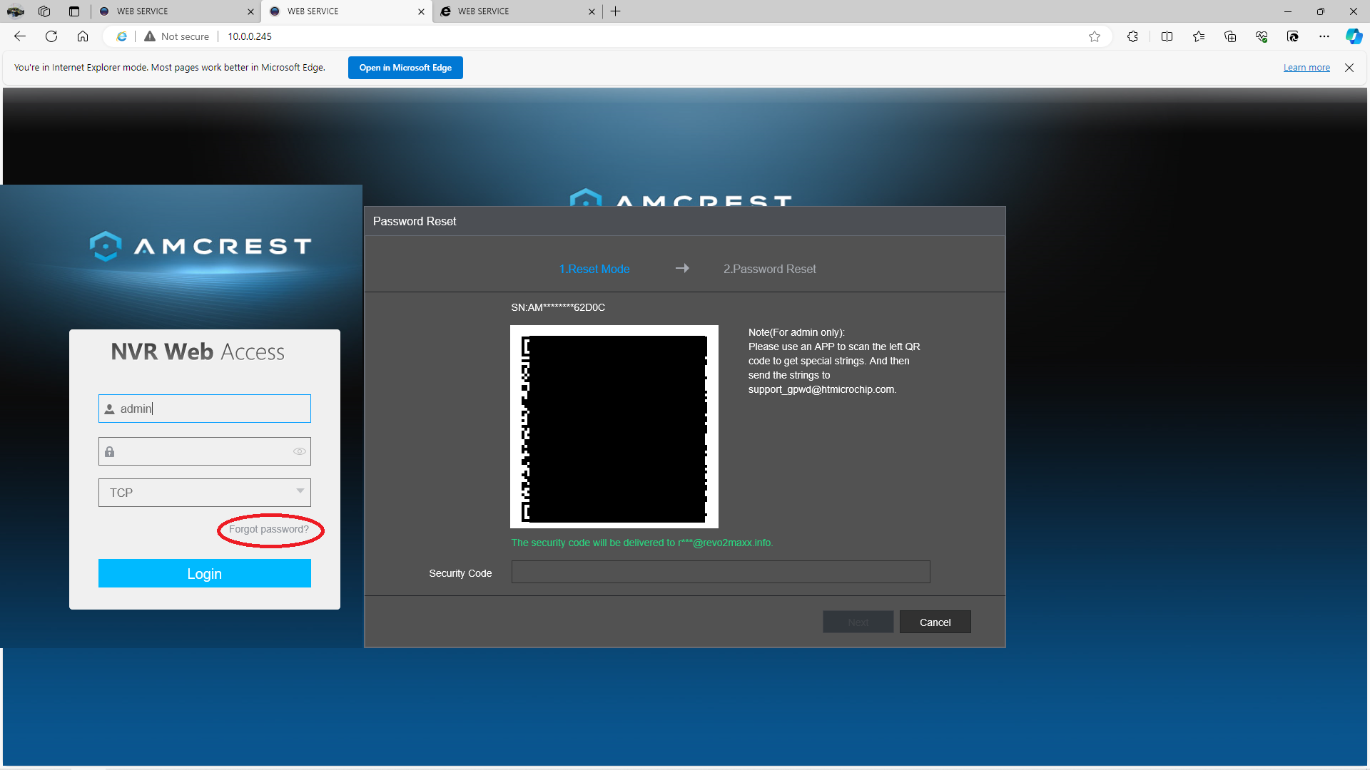

@kenf Just thought of something. This is something I can't do because I don't have any issues with any of my devices. However here is an idea. Doing this will have no effect on your system. Not sure what you are working with but hopefully it is a device with the active role of forgot password recovery.
Easiest using an NVR like a 4108-A2 or older 4108E-HS or regular HS as long as it has a FW with the option in it.. Go to the web browser, type in the Ip address for the NVR, then on the page where you put in your user and password there should be a clickable link that says Forgot Password. Click that, It may prompt you that it wants to get some data click yes, Then next page will be a QR code scan that code and send to the Email address on that page and let me know what you get from a reply. This can take a little time. Most times it is a fast within 10 min reply some times it is longer.
Don't want to know the Code, I just want to know if you get an Email reply with a Code?
If you didn't setup your device with email recovery could you for testing. If This affected me I would do it my self. Also getting the code back you don't have to reset your devices password just wondering if it would even send you the code back..
Left part of picture is first page on WebUI of the device center of picture is second page if it don't ask to get data. Some do some don't and just take you to the QR page..

@Revo2Maxx , I don't have an NVR.
