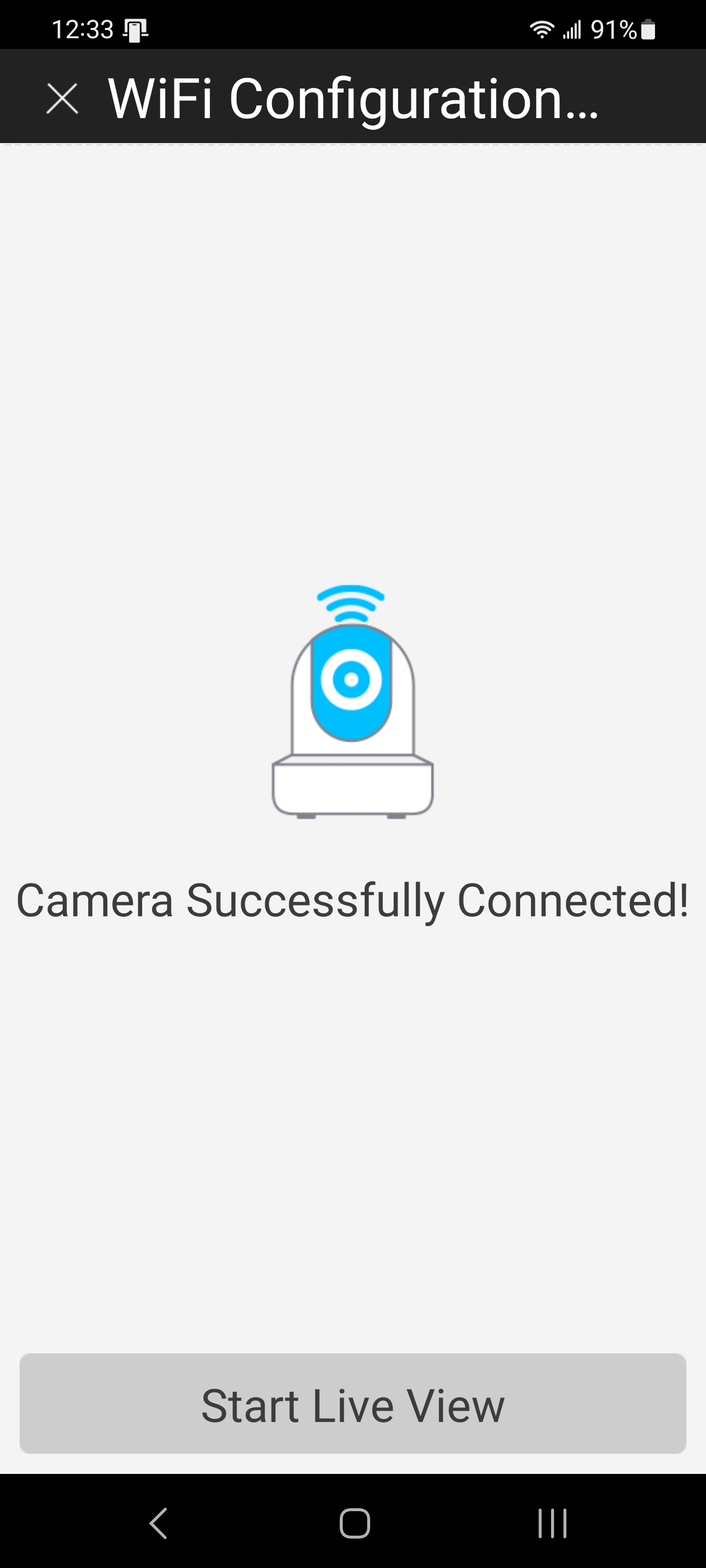

Just bought 2 IP4M-1041W cameras.
Trying to get them to connect to Wi-Fi but neither one works.
Using the Amcrest View Pro app, I tried the Ethernet Wi-Fi setup, the Wi-Fi config setup, and the Search Device setup. None work.
I can scan the serial numbers no problem, if I try the Ethernet setup it can't even find my Wi-Fi network name even though everything is working properly. With the Wi-Fi config setup, it does find my Wi-Fi network and it allows me to enter the password, but when I try to connect, the app just rings like a telephone for about a minute then gives me an error that it couldn't connect.
What's going on with this app? I have 6 POE cameras and they all connected without any issues.
Re: IP4M-1041W Won't Connect to Wi-Fi
I can't say that you issue is related to your wifi or not. What I can do is offer some info about how to connect the camera when trying to connect with Wifi. First have the camera local to you (Meaning same SPOT you and your phone are located) (Desk) then remove the camera from the app if it is on there from another install attempt.. Then press the Reset button on the camera (Even if it has not been setup before just reset it) Make sure your phone is connected to your wifi of the right one you want to use. Best luck is 2.4 if close enough to router then 5g is ok. Then once the camera is waiting to setup in the app press the +, then choose wifi camera, then scan QR code and follow what it says on the app. For me what I have found and I don't know why really. If I don't hold the phone up in front of the camera between 6 to 9 inches from lens it don't seem to want to connect. So I found that if I setup my cameras like that I can get them to connect. However if I have the camera out of view it don't seem to want to connect. Even a older wifi camera without a Mic I can setup as long as I have the camera and phone in front of one another. If I happen to be to the side of the cameras view the connection times out and I have to try again. That camera don't even have a mic so I don't know why or what having the phone in front of the camera does. However it seems to work for me.
Now I don't have a 1041 in front of me. So I can't say that it should work. I just reset one of my other older cameras and setup using wifi after removing from app. I wanted to test to see if there might be an issue on the P2P servers. It worked for me anyway
Next, If you need to setup using Ethernet first, Then you will want to again Reset the camera back to factory, Once the camera is done rebooting using your Router or using Amcrest IP config tool look for the IP your router gave you using a Ethernet Cable. Then once you have that IP type that into your web Browser IE is best however most people have lost the use of it. Anyway however you connect put in the IP, press enter and it will give you a log in using admin admin, then it will ask you to change the password. Make sure not to use something you use for your normal life and don't make it something so easy someone could guess it..
Once you have that setup and it brings up your WebUI click on setup, Network, Wifi, Then click on Enable, (Once you do it should scan if it don't scan automatically then click the scan at the bottom of the page) once you get your SSID, enter the password for your SSID, then it should show that it has connected. Once it shows that the wifi is connected you can reboot the camera, While it is rebooting remove the Ethernet cable from the camera and let the camera load using the Wifi. Now doing a seach again in your network or using IP config tools log into the IP of the wifi of the camera. Then go to Setup, Network, then TCP/IP, then changing type to Wireless and click Default, Then in there change from DHCP to Static and put in the IP you want for the camera. Once that is entered and saved it will reboot the network connection to the new IP you can if you like log back in however best to just setup the app now.
In the Amcrest View Pro App, Click the + again to setup camera, Then Wifi then top right tab should say Connected Device, Then scan the QR code and give name for camera and put in user name and password and show should be setup in your app...

Thanks for the reply !
I tried resetting the cameras then repeated the Wifi config setup.
This time I held the phone in front of the camera lens....and it was able to connect to Wifi !
I don't really understand why it worked though. What is the camera looking at? There's no bar code to read or anything.
Is this some kind of NFC (Near Field Communication) ?
Anyway, I'm just glad it works now.
