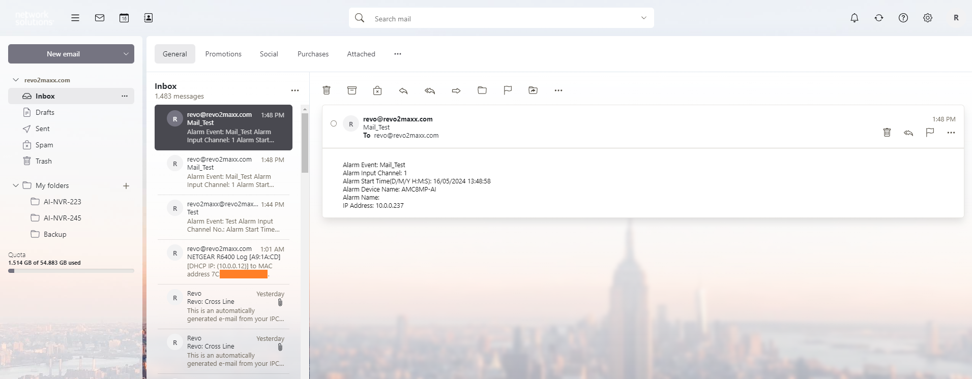

Re: IP4M-1041W Can't Change Email Password
However I have found now that in fact my V3 camera won't connect to my current email server either.. Now I am not sure what the issue is. It has been a year since I did any emails from that camera because it is setting behind a NVR on a VLAN so I don't have direct access to the camera normally so I have moved it back to local lan with internet access and it fails on my revo2maxx.info server and my revo2maxx.com server has crazy long email server address that only using that right now for receiving emails.. Most of my devices won't work with the SMTP server for that one.. will do some more testing if nothing works before end of day I will put camera back on the VLAN it was setup on..
So I don't know what is going on. I just double checked and updated my newest Amcrest camera that also acts like the v3 cameras you are dealing with and only shows 6 * for the password. Even in the WebUI after you setup and leave the page, When you come back to the email page it will only show 6 * but in the list here, I did a test with SSL enabled. I then changed to TLS and port 587 did another test and that is from my crazy strange SMTP server even.. The 3 test if from one of my NVRs that as you can see the sender is revo2maxx and not revo as the 2 top ones are.. I will try a to add in my crazy server and see if the v3 camera will take that one.. Right click and view in new tab to see clearer picture..

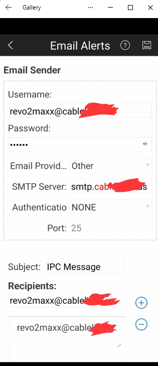

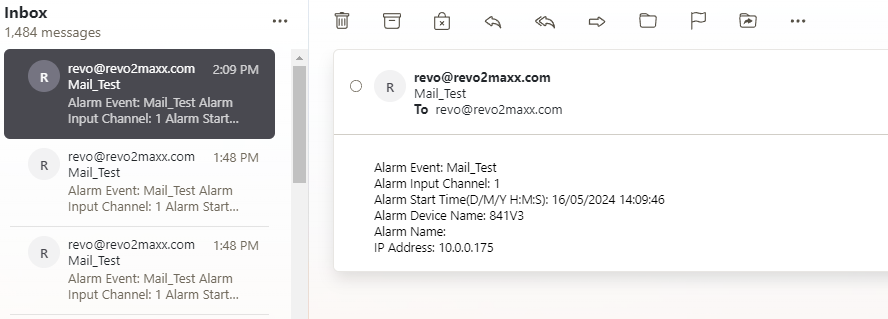

Well having my crazy email server in the v3 works my semi normal email server don't. I don't know if it don't like that it is a .info and it is looking for normal type like .com, .net, .org kind of thing and thinks the .info is bad format? However it does use the extra long email server that some of my other devices won't work with..
