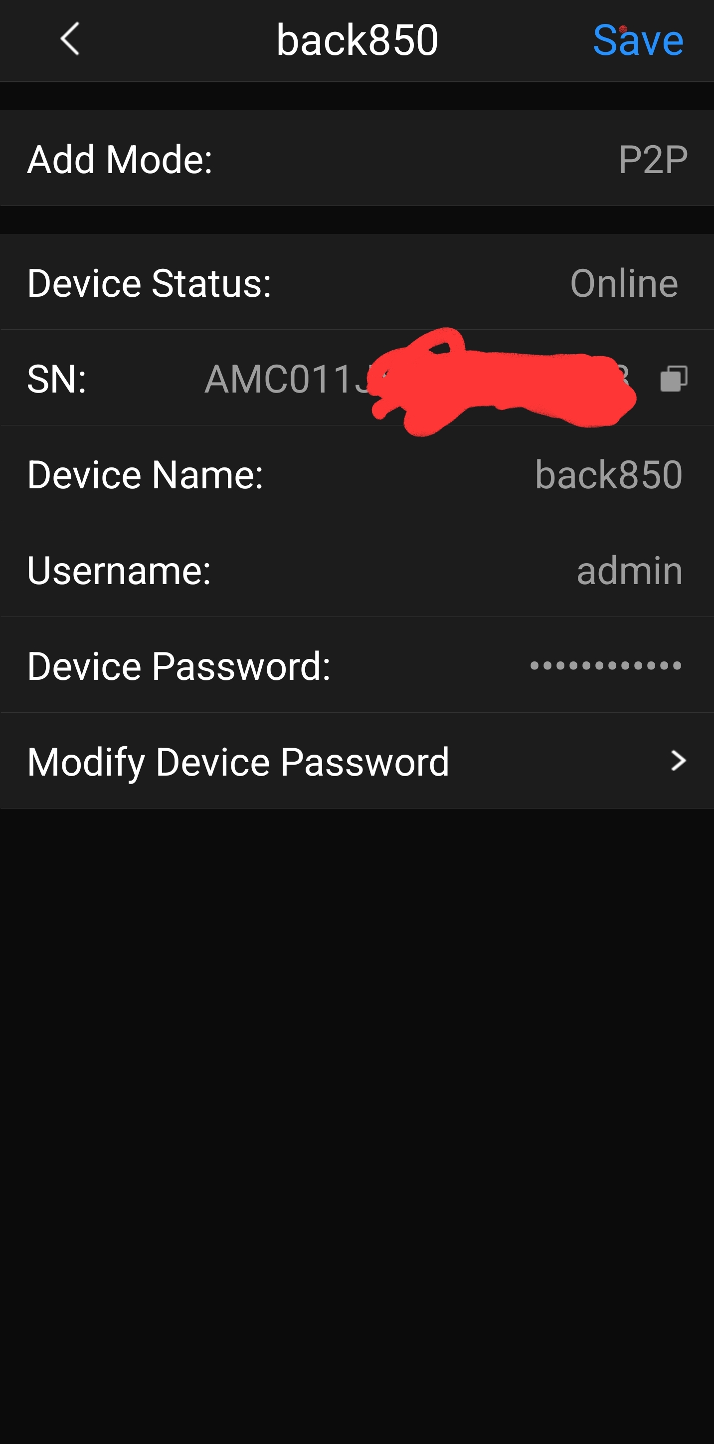

If you do then being up AVP2 and click on the device you want to change, Then click the top right icon, Then at the top of that window where the name of the device is click on the box with what looks like a Pencil in it.. Then at the bottom that is to change the password if you already know it. The line right above that is password it will look like you can't do anything just click it or touch it however you like and it will bring up editable area. Put in the correct password and should be able to connect..
However if you don't know the password for the camera you will need to get to the camera, remove 4 scews off the back and click the Reset button and hold until the camera starts the dance..
