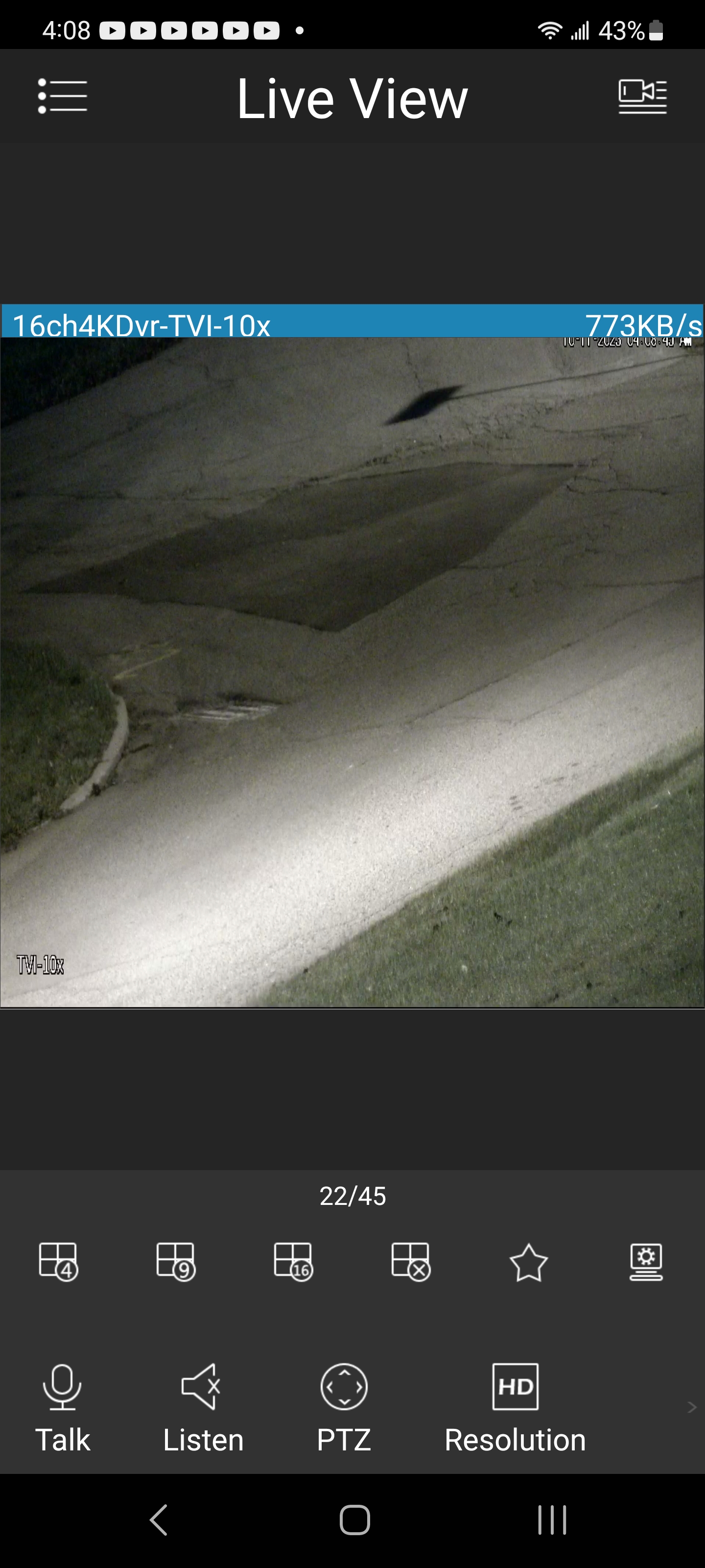

So rather than clicking on the O for the device click on the left side >NVR or >4116E-HS and then in the drop down click on the channels that are filled. If you have lets say the first 20 channels of a 32 channel NVR then click only the ones you have installed. Rather then the O for the whole NVR. When you close out of the AVP and then bring it back up it will have your list of cameras still in Live View Mode and go from there.. As you can see in the picture below I have over 40 cameras added into my AVP and when I load it they will come in every time. Now when I add a new device or I go back and makes changes to where I only want to work with let say my older 4108E NVR that is because I changed a Camera or added a new one to the list and want to view just that then yes I have to go back and add in all my other devices to my Live view list But for ones that only have 32ch and only have 18 to 20 cameras that isn't as hard as loading back in 40+ devices lol..
See Picture Below for what I am talking about. Looking at the AVP you can see I am in 1 channel mode looking at Camera 20ish I forgot what one but might be 20 of 40 that is setup I can scroll one at a time or click to change how I want to view them in 4*4 and so on..

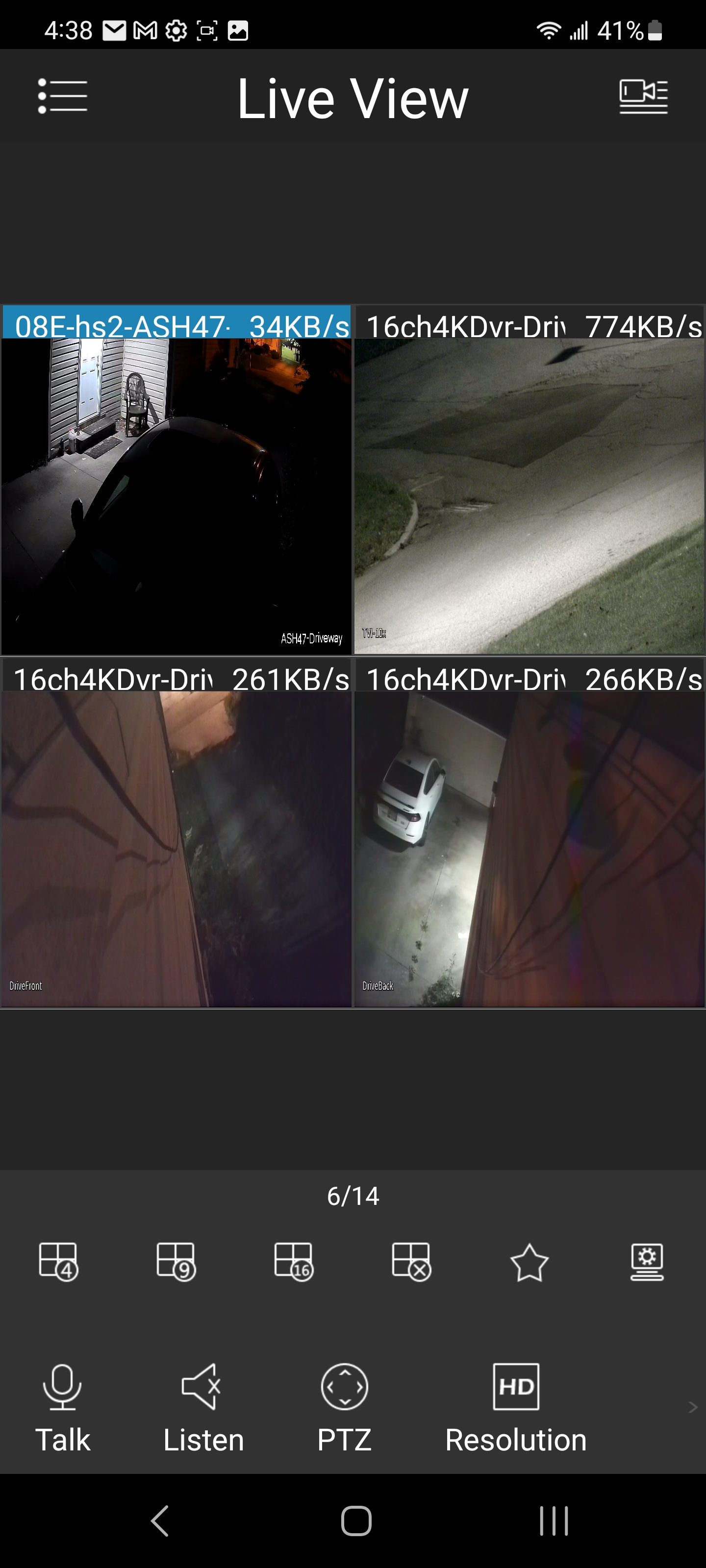

Here is a 4 view I added few more devices now have 56 in my list but this is only showing 4 of them. So shows how many 4x views I can see with them added channels.
