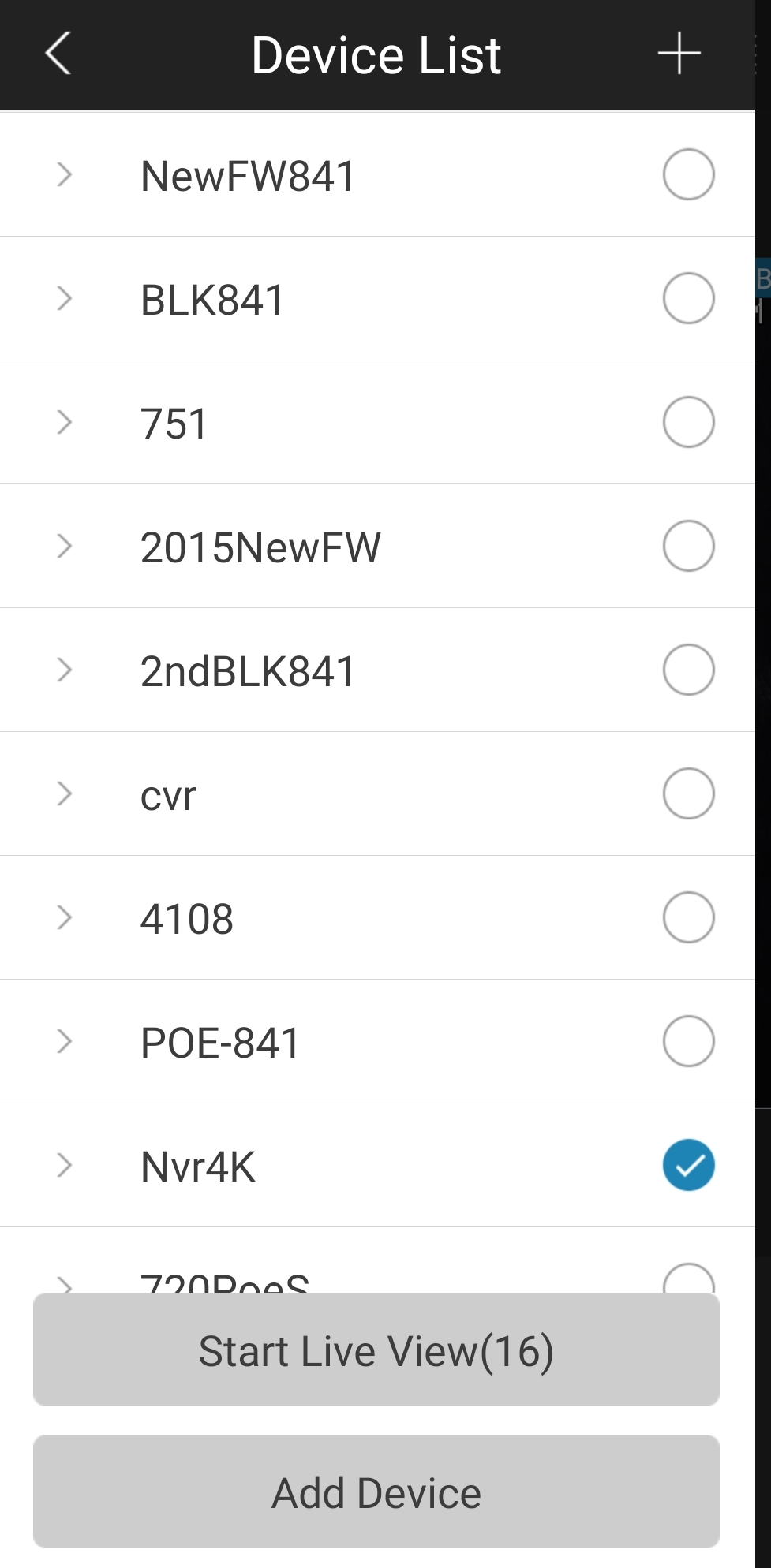

Re: Cannot connect with S/N
So if you are working with just 1 phone and device maybe there was an issue with the install of the software.. I would try and remove it and add the software again... I have a few items in my list if I had to delete and add again I would toss in the towel lol.. However if your on a phone that has not had one active yet it might be an issue with software..
Once installed again. You will click, you have to make a name for the device on the Phone because you might call it what you like but someone other then you might not understand that so for the sake of keeping them different between devices you put in a name,
SO after you press the + then pick the type don't forget to change the top tab to Add Connected Device if you keep the first Tab (Connect New Device) you will have to act like the Setup for the camera is new.. Then Press the P2P Option then Scan the SN if you are by it if not click the Enter S/N Manually then enter the S/N Then next screen it will ask for the Name Put in a Name, then put in the password for the camera once you have that click on the Start Live View and camera should be added....
