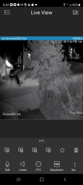

So I know that you said yours is a S10, I have just checked my Devices, S9, S9+ and S20 all of them are working as expected in IP and P2P formats.. I made a Gif of my S20 working.. I will admit it did take a little bit for the S20 to Setup the AVP over my S9 and S9+ when I loaded the app I thought it was going to fail I just waited and it worked..
