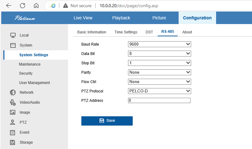

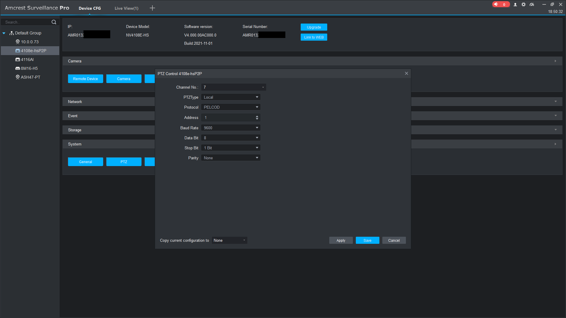

So to expand on my answer, In asp you might have to config your NVR to access the cameras ability. It may or may not work. Anyway in ASP click the + and bring up Device CFG, Then click on the NVR. Then click on the system, PTZ and choose the right camera you want to make change to, then click on Local and make sure you add in the right data for your camera. This info can be found from the camera WebUI most times I can't say that it is in your SV3C cameras but they are in my Hikvision cameras..

I found it and thanks for the step by step directions. Now I get to the confusing part. My camera configuration is way different then what I see in ASP, but I kinda of figure it would because of the manufacture. From what I see in mine compared to your is that you have PTZ Protocol with a word. So I looked at mind and under Protocol it has NONE, but if I hit the down arrow, it shows a list of stuff such as "General or PELCOD-S1 or SONY". Does this mean something or something special about my cameras? Then I'm wondering okay, so where do I enter this "Call/Transfer 210" at in ASP?

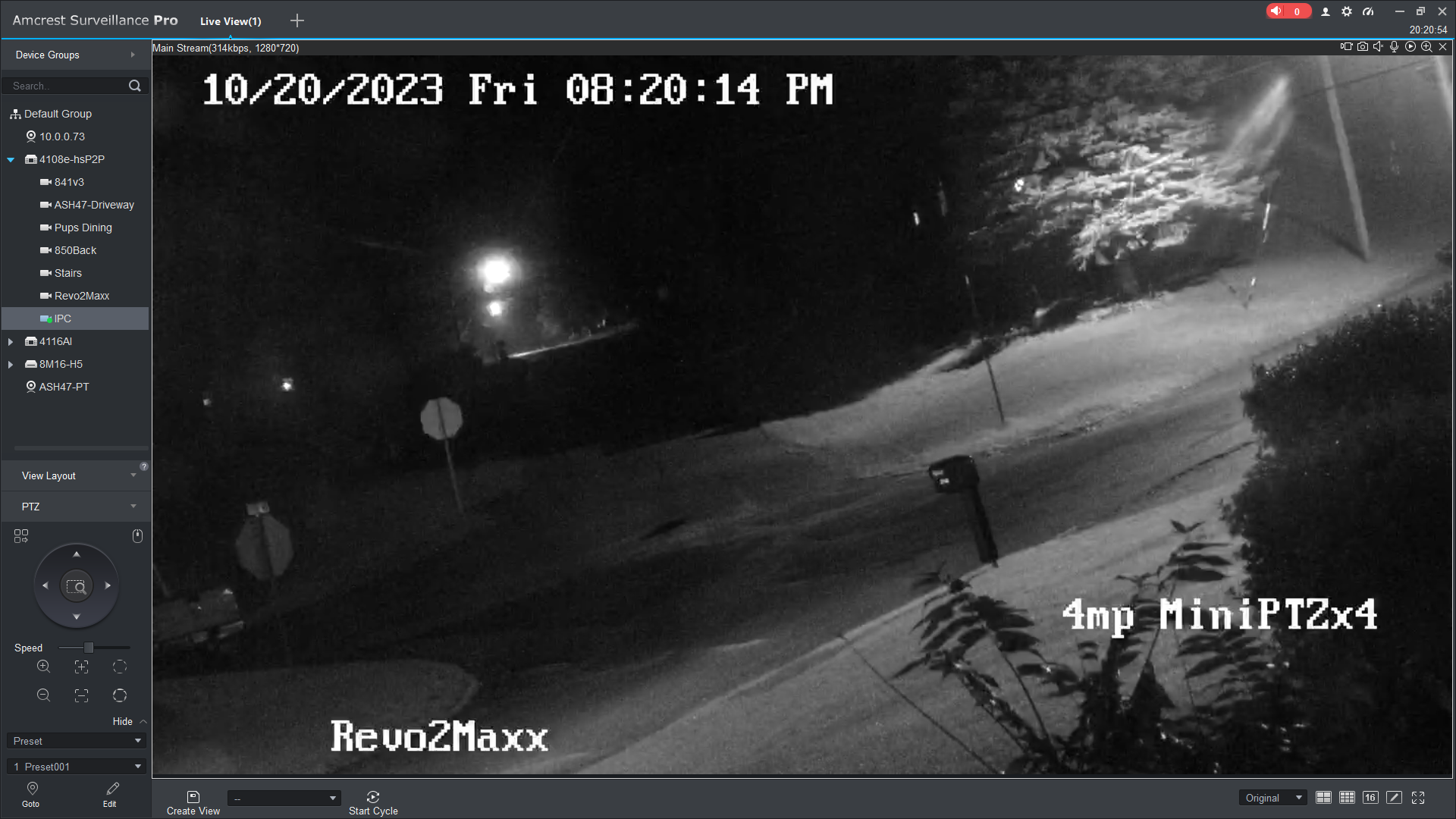

Not sure I understand? However if you are asking about how to access the PTZ Presets in ASP then in the picture below I have expanded my PTZ and More in there is where you can call and set Presets. If you are not asking that then please explain more?

Basically where do I put Preset 210 at in my ASP/camera?
Re: Call/Transfer
Awww Ok, Sorry I guess it seems that ASP has a 128 max preset or something, Seeing I just looked at my other camera with 300 presets and sure enough I don't normally go over 110 or 120 anyway I never seen that ASP only seems to go to 128. So in ASP I guess there is no way and will need to use your Cameras app if it is able to call presets or if the preset is able to be copied in software to a lower number then I would copy it to something that is free between 1-128..
