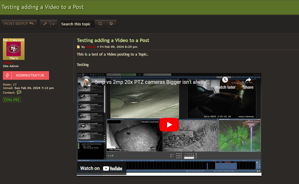

Only way to share a video is to upload to Youtube, Twitch, Facebook Watch or some other video sharing platform and share a link to the video on the forum. Even in my forum where I do have a Media button for sharing a video that can be seen right on the thread the video has to be hosted on a video sharing platform first.
Screenshot (1393).png (333 KiB) Viewed 8777 times
