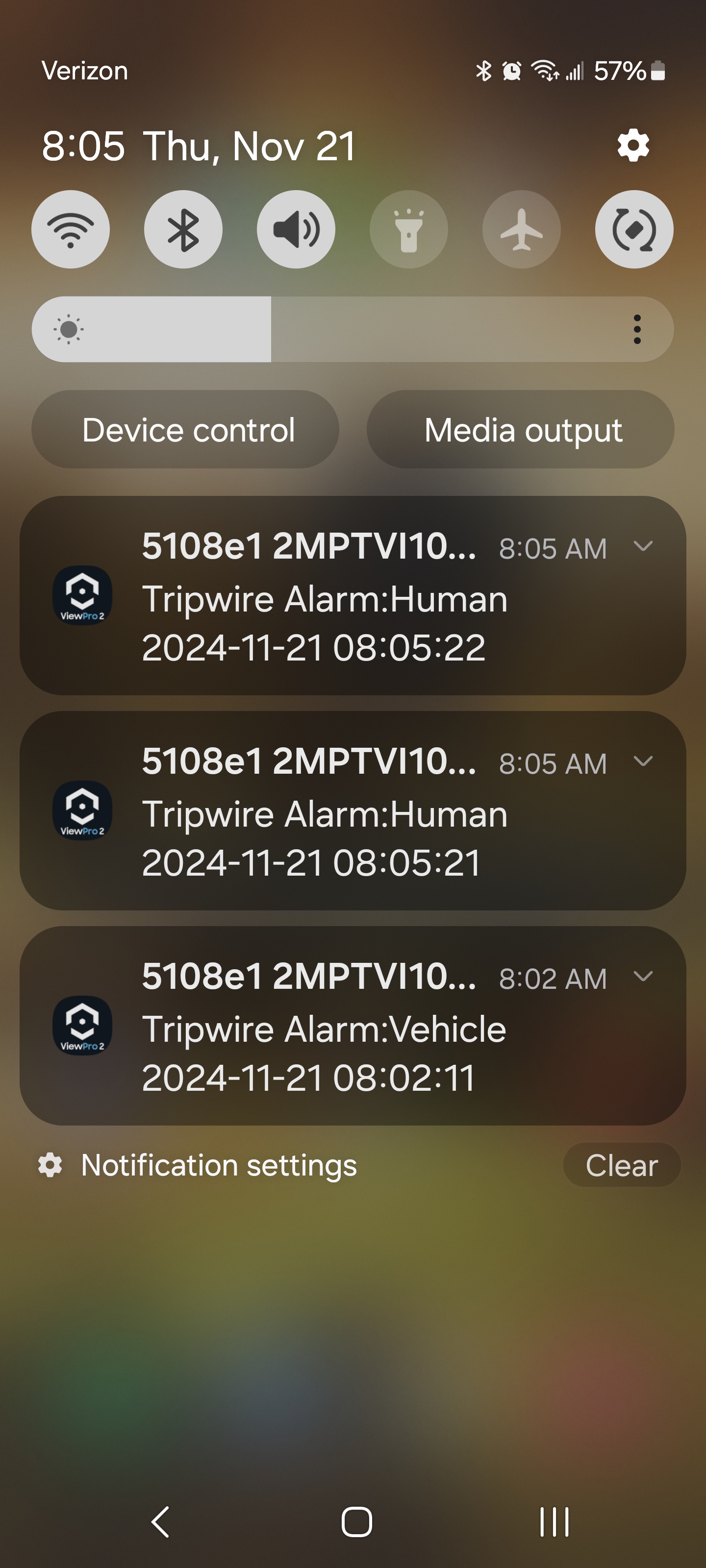

Re: Amcrest View Pro NOT WORKING
Download the Amcrest View Pro 2. While it isn't 100% perfect, it is better then the first and does send push notices.
