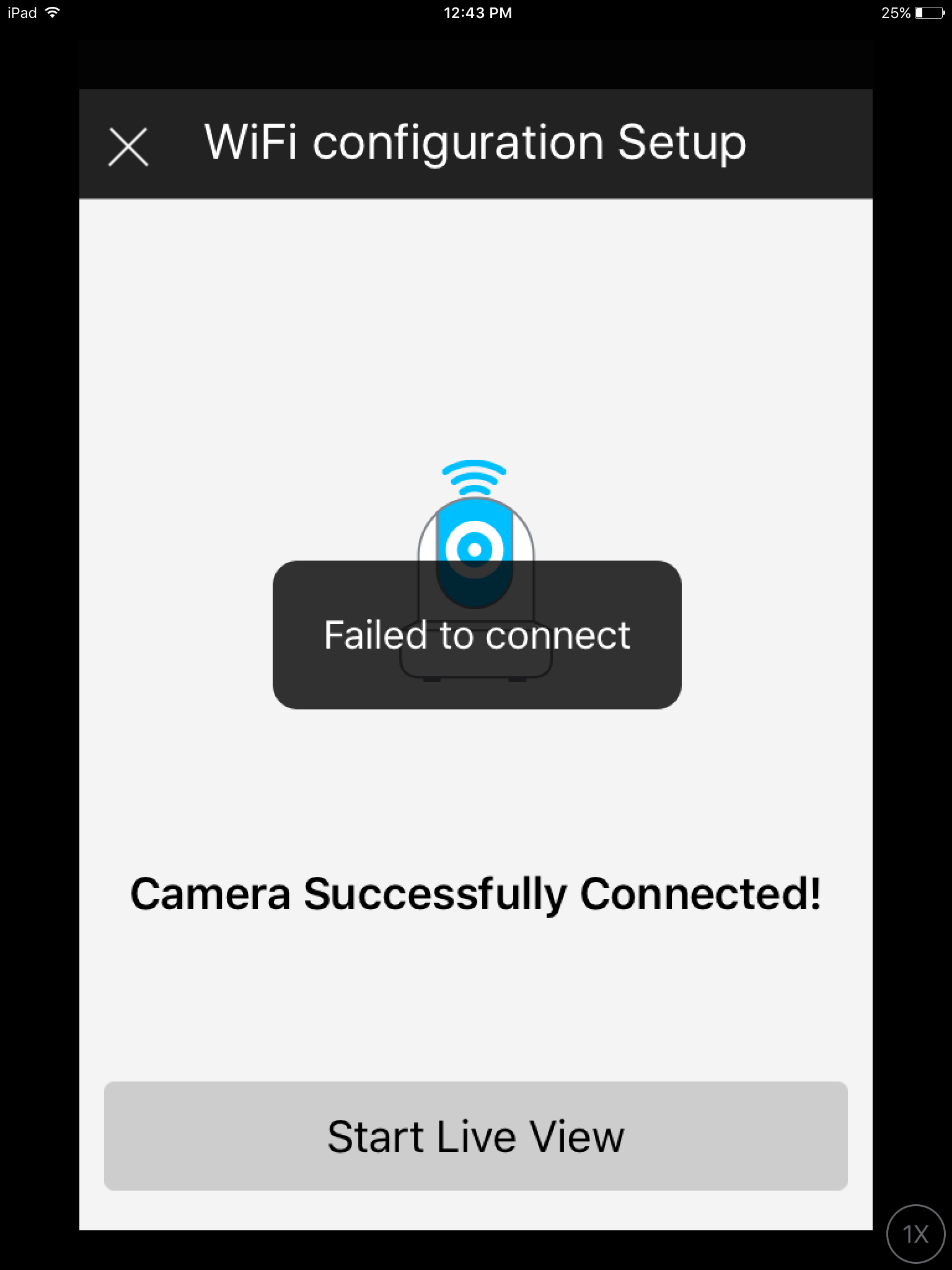

I recently bought new amcrest camera, it's working perfectly on my wife's Android phone and windows laptop, I can't connect to my iPhone or any iPad, I just call today and they accept is a know ISO issue, when is going to take they upgrade de app??

Thanks, still not working on my iPads or iPhones.

+1 for this problem. My iPad app and Amcrestview.com no longer work with two of 5 devices in my shop. They report "failed to connect " or "Incorrect ID number or the device is not setup for P2P" in the "Device" section of Amcrestview.com. The iPhone IOS app stopped working for these two devices last week along with the iPad and Amcrestview.com but iPhone started working yesterday. However, the iPad app and Amcrestview.com still fail to connect. I'm glad that at least the iPhone is now working but it is entirely too small a screen to use. The iPhone app will not work on the latest iPad IOS. It does not support iPad parameters. FYI - This applies to inside and outside of my LAN.
