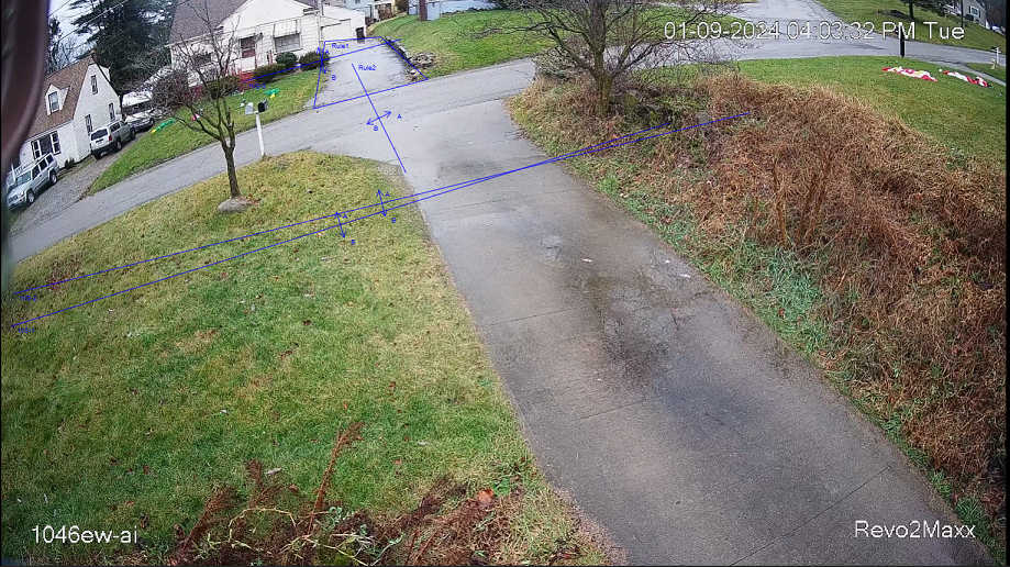

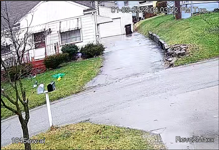

My guess is that you have the app showing 2 different stream types? I don't know for sure just a guess. Most apps won't allow 2 different setups of the same camera so maybe you were using 2 different apps and one was showing Main stream and the other showing Sub stream that is able to show a different view from same camera. However if you have a 2 lens camera then that is a different things all together. What camera are you using, might help answer your question. Here is a couple of pictures of one of my Amcrest cameras that I can use the Sub2 stream to have a different view. It had options to have bigger sub channel option however I wanted the much different look so I chose the 720p option in setting it up and able to point the box anywhere in the main area of view. Is something like that what you were talking about or is your camera a dual lens camera?
