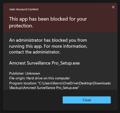

I have three PCs running Windows 11 Pro and ASP and after update KB5029351 the software will no longer open on any of PCs. I tried turning off User Account Control and it had no effect. Is there a way around this? The newer software works but the download speed is HORRIBLE...
- Blocked.jpg (101.92 KiB) Viewed 18162 times

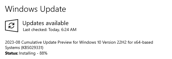

I have the same issue. As of the last update on my two systems, I'm showing 8/22/2023 there was a Microsoft Windows Defender Update KB2267602 installed, that may be the issue. No other updates were made to my systems, but now I have the error:
This app has been blocked for your protection.
I tried a few options but have settled with running CMD Prompt in admin mode and pasting in the path of the exe file. This works. I would not recommend shutting off UAC for your entire system as is mentioned above.

I found a work around by modifying the Group Policy Editor:
https://www.makeuseof.com/this-app-bloc ... 20Disabled.

I tried your fix and it worked perfectly! I have 4 PCs running ASP. All working fine for years. 3 are Windows 10 and 1 Windows 11.
In the afternoon of Aug 22, 2023 all computers suddenly had the same problem: message that an ADMIN has blocked the app. I run all PCs as an admin so was puzzled but figured it must be from a windows update. I tried several possible suggestions from an online search to solve admin problem but yours was the only one that worked. HOWEVER, I am a novice at dealing with the registry and always fearful of messing things up. By making the change you suggested can it potentially cause another problem or leave me unprotected?

Experiencing the same thing, since yesterday 8/22/23, on Win11. Running for over 6 years. I am on ver 1.1.4.0. What ver are you guys on? Also i dont know if this has anything to do with this issue but the digital signature on the exe did not have a time stamp. Maybe the certificate expired?
Read an article that said: "The Windows 10 User Account Control (UAC) blocks running/installing applications with an expired or revoked digital signature. You can verify this in the properties of the executable file on the Digital Signatures tab. Most likely the Code Signing certificate has already expired."
