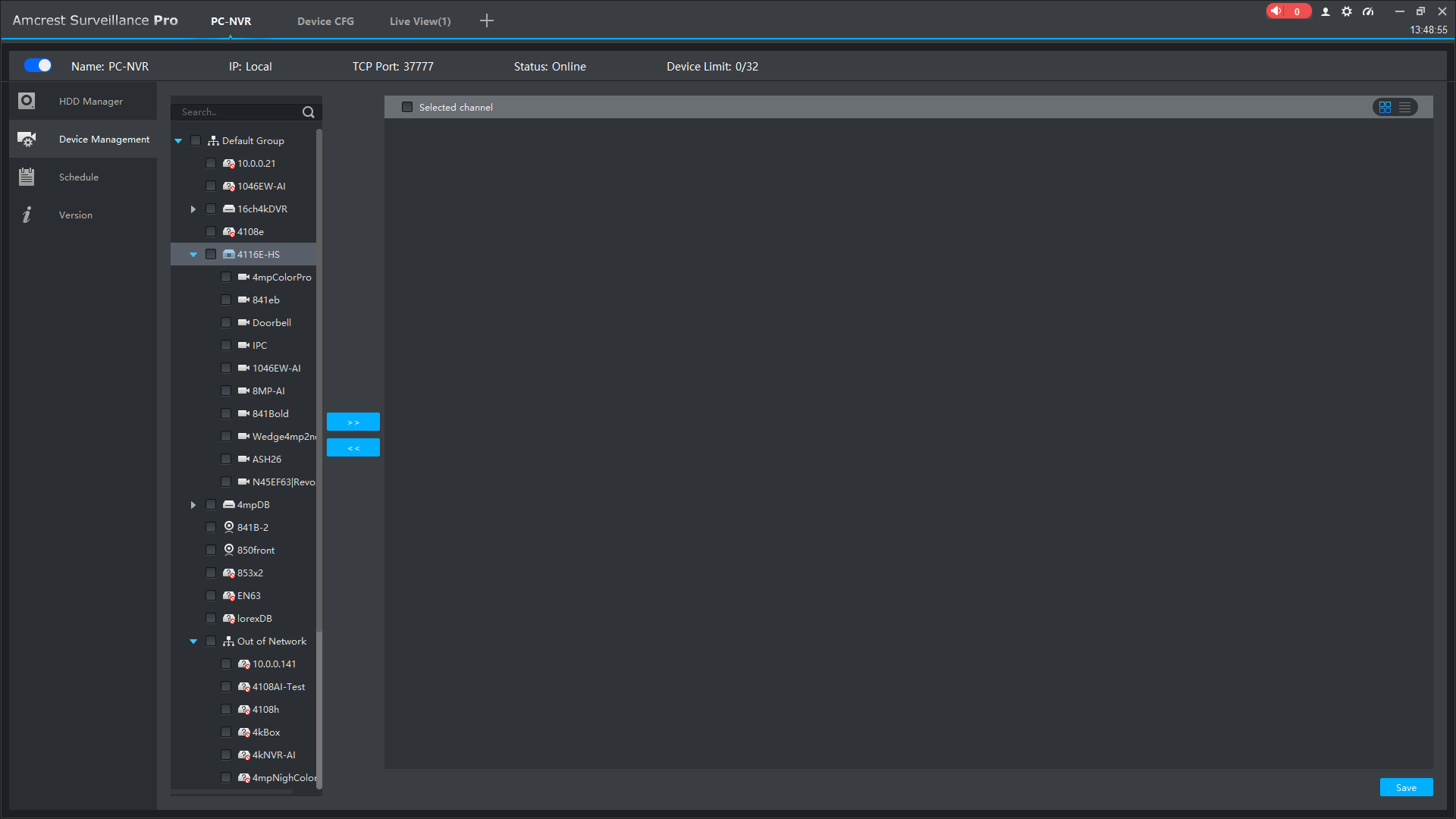

I have never had any luck with this program recording.
I don't know what the trick is to get the cameras to record, 24x7, based upon motion detection.
I have 14 cameras, all IP POE, setup on the network. They are discovered in Surveillance Pro and I can see the live video.
I have each setup with a check box by motion.
I have the drive\path setup for the software to dump the video files but nothing ever shows in the dir.
Can someone tell me what I may be doing wrong? Thanks, Dave.

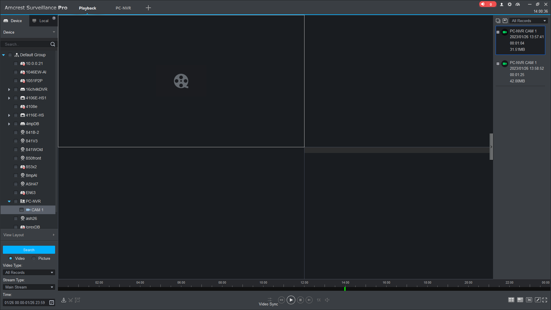

You will want to make sure that you add in PC-NVR into the ASP. You will add it like you add a camera and will have to setup in the PC-NVR room for the ASP to record. At that time you will have the ability to setup a Schedule just like you can within a normal Amcrest NVR. Only down side is that the Computer will need to be online full time 24/7 for things to work as expected.
Screenshot (3893).png (74.11 KiB) Viewed 3134 times
Screenshot (3894).png (84.48 KiB) Viewed 3134 times
