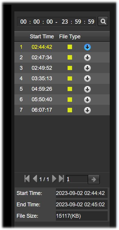

This is a problem that I've been aware of for some time. TBH it's not important to me but it piqued my interest anyway so I thought I'd see if I could find a way to get round it. This is what I cam up with.
I gave up on ASP and looked at my camera's Web GUI. The screenshot is a part of the "Playback" page.
There are two options for the recording at 02:44 hrs either to double click the entry or to click on the down facing arrow. Double clicking plays the video in the current page but clicking on the down arrow opens a new tab into which the video is loaded in a matter of a few seconds. Right click on the video in that new tab and choose save as. A bit clunky but at least it works for single files.

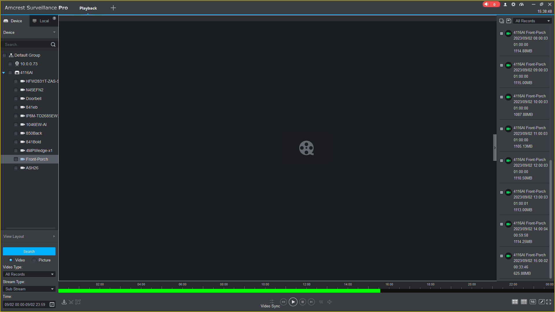

I don't know what or why people are having issues. I just checked my ASP (New One) and dl a file that was 149mb long and it took less then 20 seconds to DL to my computer. If you are trying to DL from a Remote device then that could be a whole different game of issues.
I DL a few different ones. Event ones on my 16ch NVR that is full time writing 8ch at the same time DL a 470mb file and took just about 1 min to DL the file. I did confirm the files are good in folder as well. So could be a connection issue..
Re: Slow Download of Video Files
So I did a fast unlisted video of a DL of sub stream 1 hour clips x2 and was less then 2min 20 seconds.. First one was about 1min 4 seconds at Verify time and other one came to an end at 2min 12sec that was total time for both clips. This was in AVI format but I did test it in both only recorded it in AVI and both MP4 and AVI came out to about the same DL time.
Also after making that video I looked at my front porch video files that are larger as they are not in H.265 only h.264h and the files were over 1100mb and total time to DL in MP4 format was 2m 12sec.
https://youtu.be/h9qcFQPfyAg
Screenshot (80).png (94.93 KiB) Viewed 14410 times
