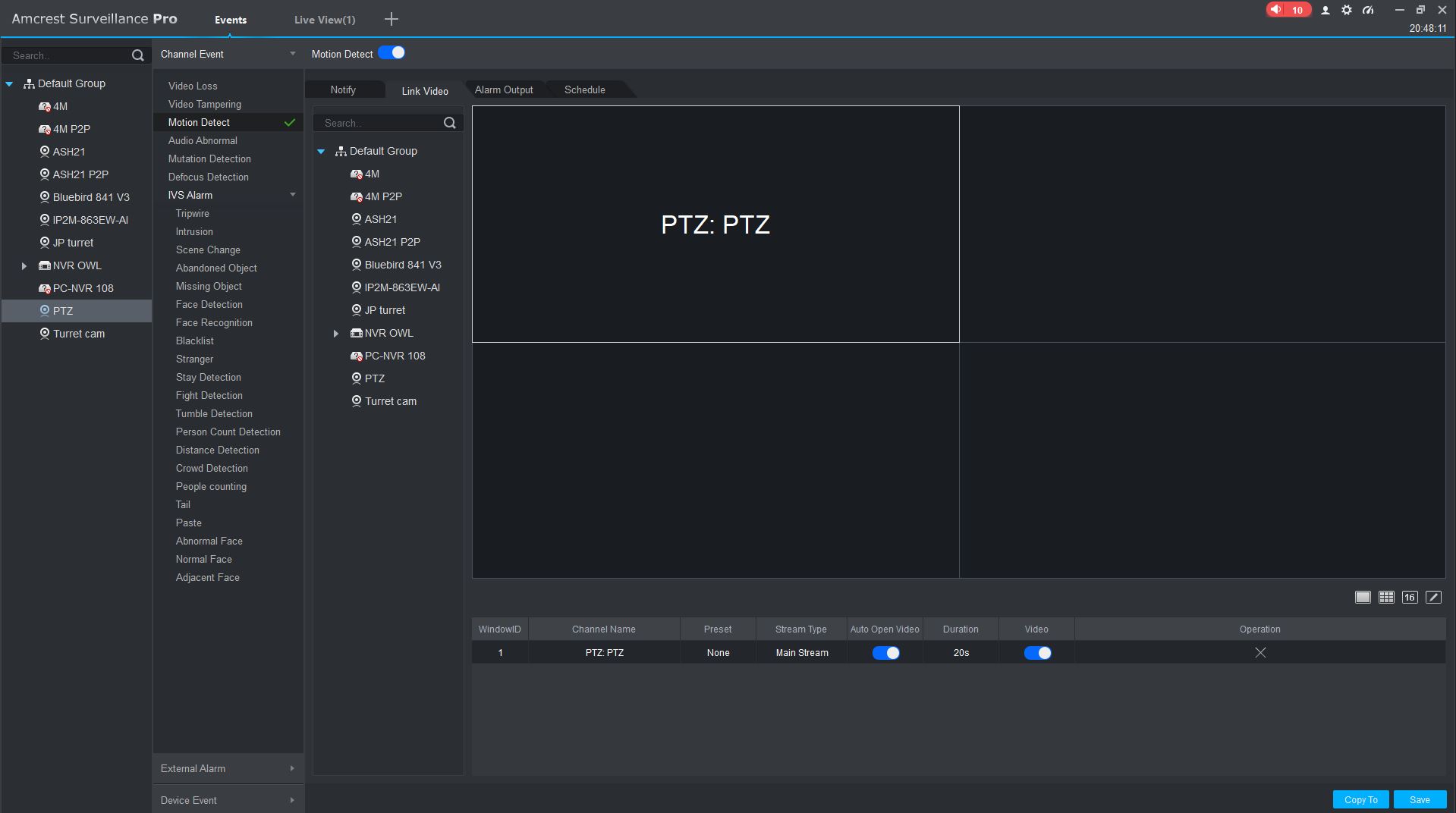

The following screenshot shows how I set up ASP Event to popup a Playback whenever motion detect occurs on a camera. The popup playback will immediately appear and playback anywhere you are in Windows if ASP is active.
popup playback.JPG (122.27 KiB) Viewed 1362 times

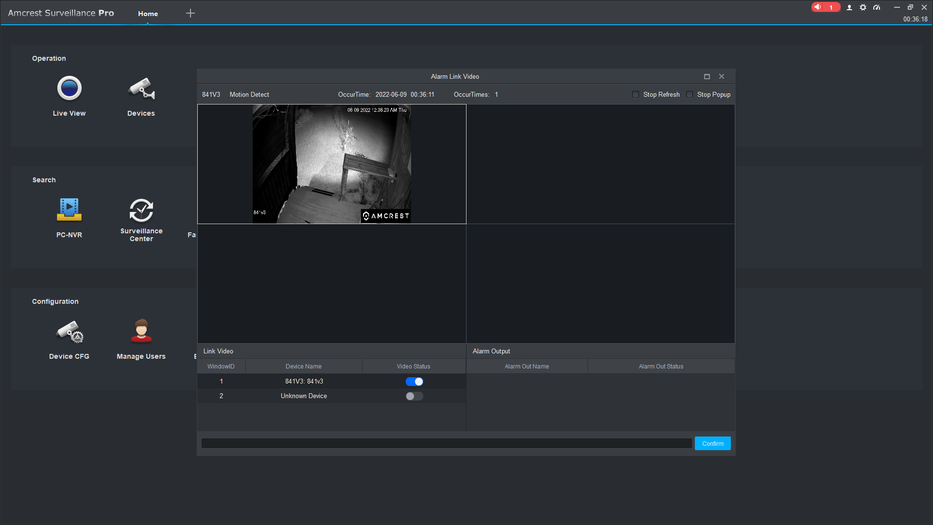

Ok sorry I just know that you use ASP more then I and thought you might know. Here is what I am talking about.
Screenshot (2544).png (157.37 KiB) Viewed 1357 times

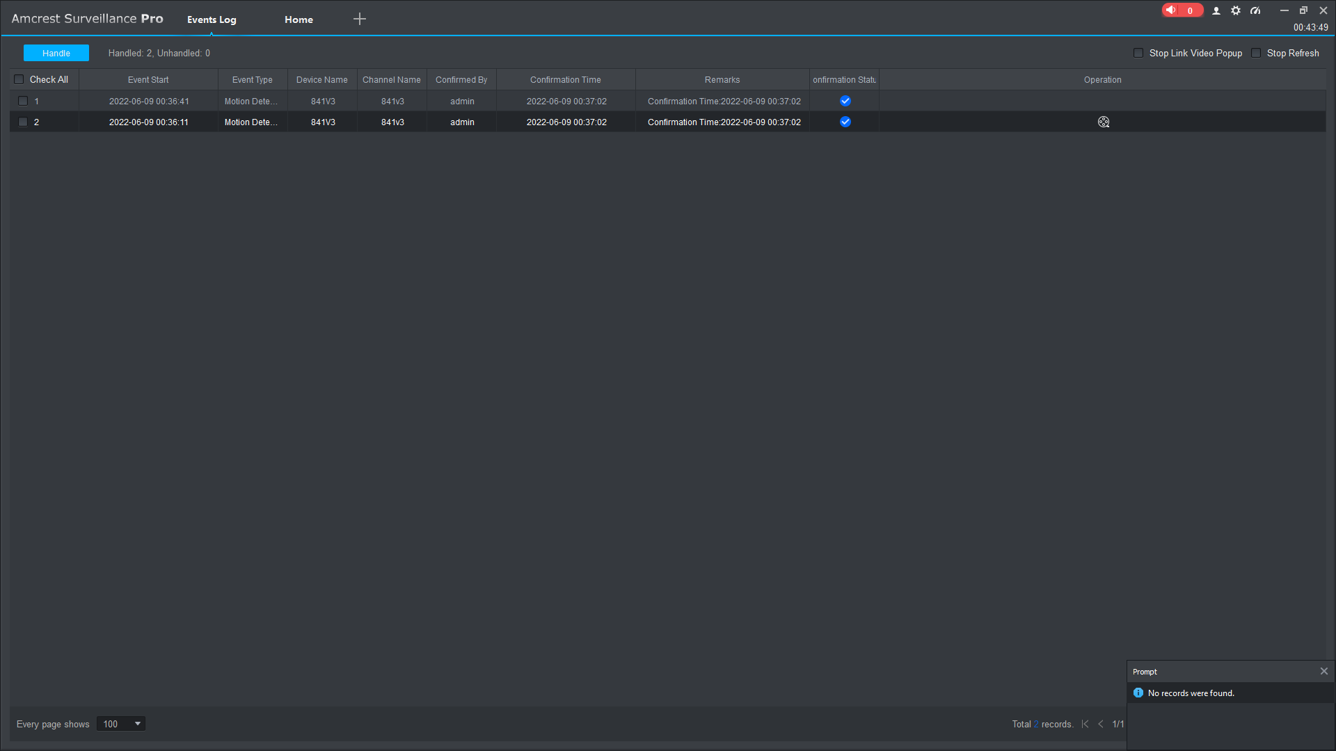

Removed and added first one of the next post. I could delete this and add text but when I tried to edit and add it failed so new post with 2546 with error that was missing in 2545
Re: playback from event popup

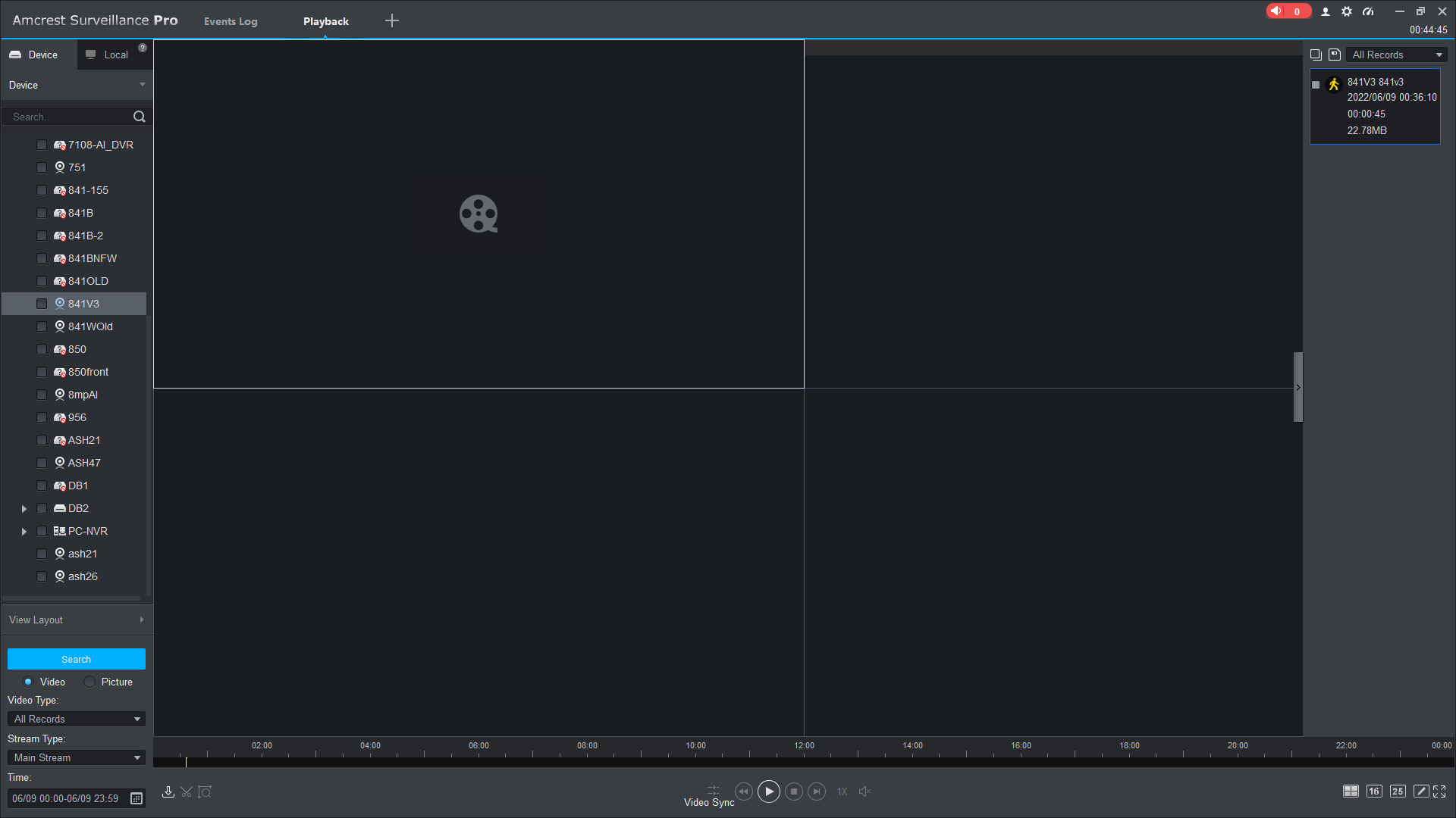

Anyway normally with other hardware I have if you click on the one with the Record wheel it will playback the item recorded. However if we look at the time and the time it was done recording that translates to the recorded event if I look at the cameras MSD.. So lets say I was away, I got my Popup as expected and when I come back I want to playback rather then making me have to search for the event and tonight is easy because that event was caused by the IR of my 850eb. Normally there could be many events that I would have to sift though to find one I want. However being able to click it like I can again different hardware and it playsback when I click this event I get a message that there was not event.. So I am wondering if there is a flaw in ASP where it is doing end time and not the event time and that is why it can't find the event? Note really a Problem just asking..
Screenshot (2546).png (41.58 KiB) Viewed 1357 times

Well, I fould the wheel icon over on Event Log. To play , the device name on icon adjacent right side must be clicked.(??) It plays a Local recording, Not SD card.
Over on Playback, Local and SD card recordings can be played. Start and stop times seem to be wierd everywhere. Overall, I think it's a mess.
I went to another PC with SmartPSS and it seemed to do the times right. It appears PSS is a little newer version but is still old.
