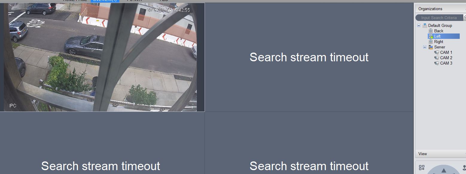

everything was working fine until i updated my ip2m-841 camera firmware. i can still see live streams on the cameras but now it doesnt show a live stream nor record under my PC-NVR tab.
what i did so far.
1. hard reset the camera- same results
2. uninstall amcrest software and reinstall - same results
3. add/remove pc-nvr device and space allocation and re-add it back (i do see the streams when adding the cameras here but that was in all the scenarios)-same results
4. called tech support TWICE! - what they did - add and remove pc-nvr device.. 5x... no result.
claimed they will add my name and number for a callback from the houston tech support level 3 or what not and still have not heard back.
PC NVR not recording after camera firmware update
