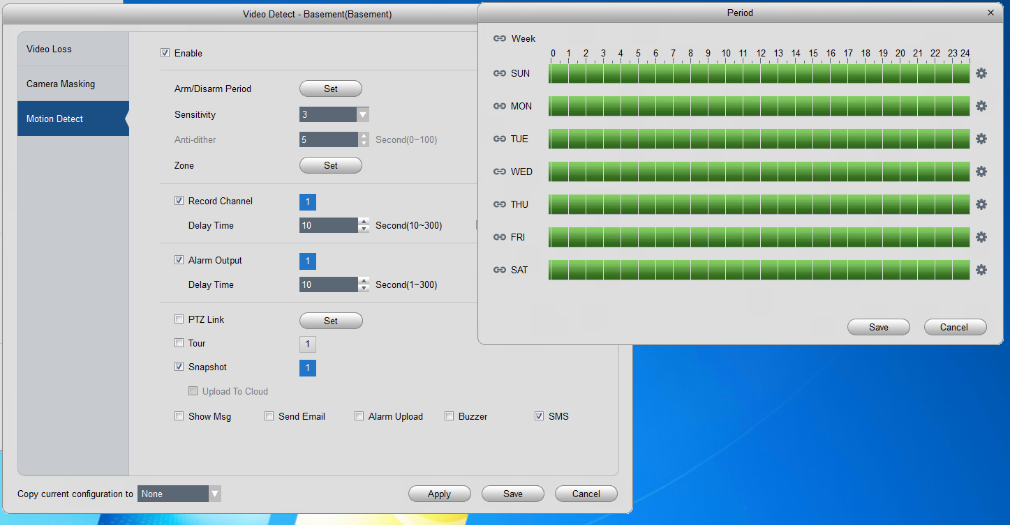

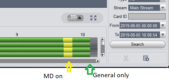

So do you have your system set like one of these pictures in your Record area? also can you confirm that you don't have it set to only record Motion at 0 time and record set for all time in other areas. Meaning looking at your Video Detect area then Motion Detection, is it Clicked to record motion. Then do you have the Grid set for where you want it to detect and what are the settings for Detection?

I had a camera(IP2M-858) last year that showed green for MD events. So if using Regular and MD at the same time, you can't tell where the MD events are. New firmware corrected that. May not be your problem.

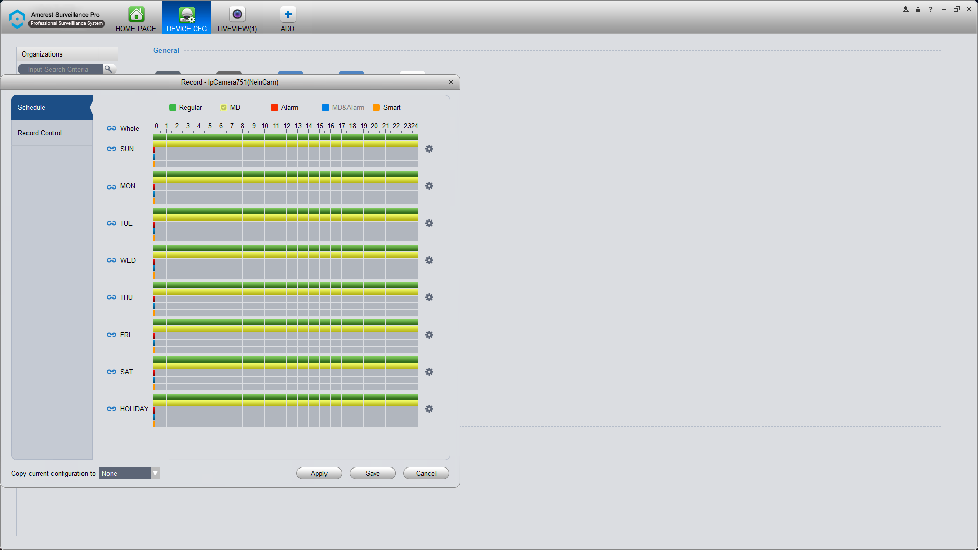

Make sure the Record Plan in PC-NVR section is set up properly. Select camera at top, click on gear icon(s) at right, specify schedule, select Regular and/or MD there, and Save, and Save anywhere after that.
PC-NVR is capable of showing green and yellow at same time on same line.

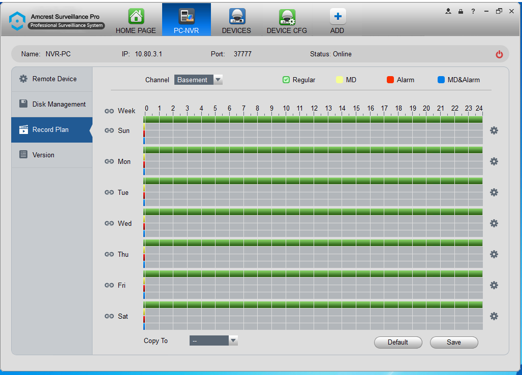

PC-NVR settings
PC-NVR default settings.png (76.8 KiB) Viewed 3339 times

So I followed your instructions and while it didn't fix it I think it has started to point me in the right direction. It seems there is something wrong with my PC-NVR software. As I was going through your steps and setting the record plan on my PC-NVR I noticed that I had 4 "Unknown Channels" in my schedule list. Well after another 30 minutes of messing around I ended up removing all my cameras from PC-NVR's "Remote Device" list. And I still have 4 "Unknown Channels" in my "Record Plan" area that I can set a schedule for. I've tried uninstalling the PC-NVR software and reinstalling it and they are still there, even before I add any cameras.
