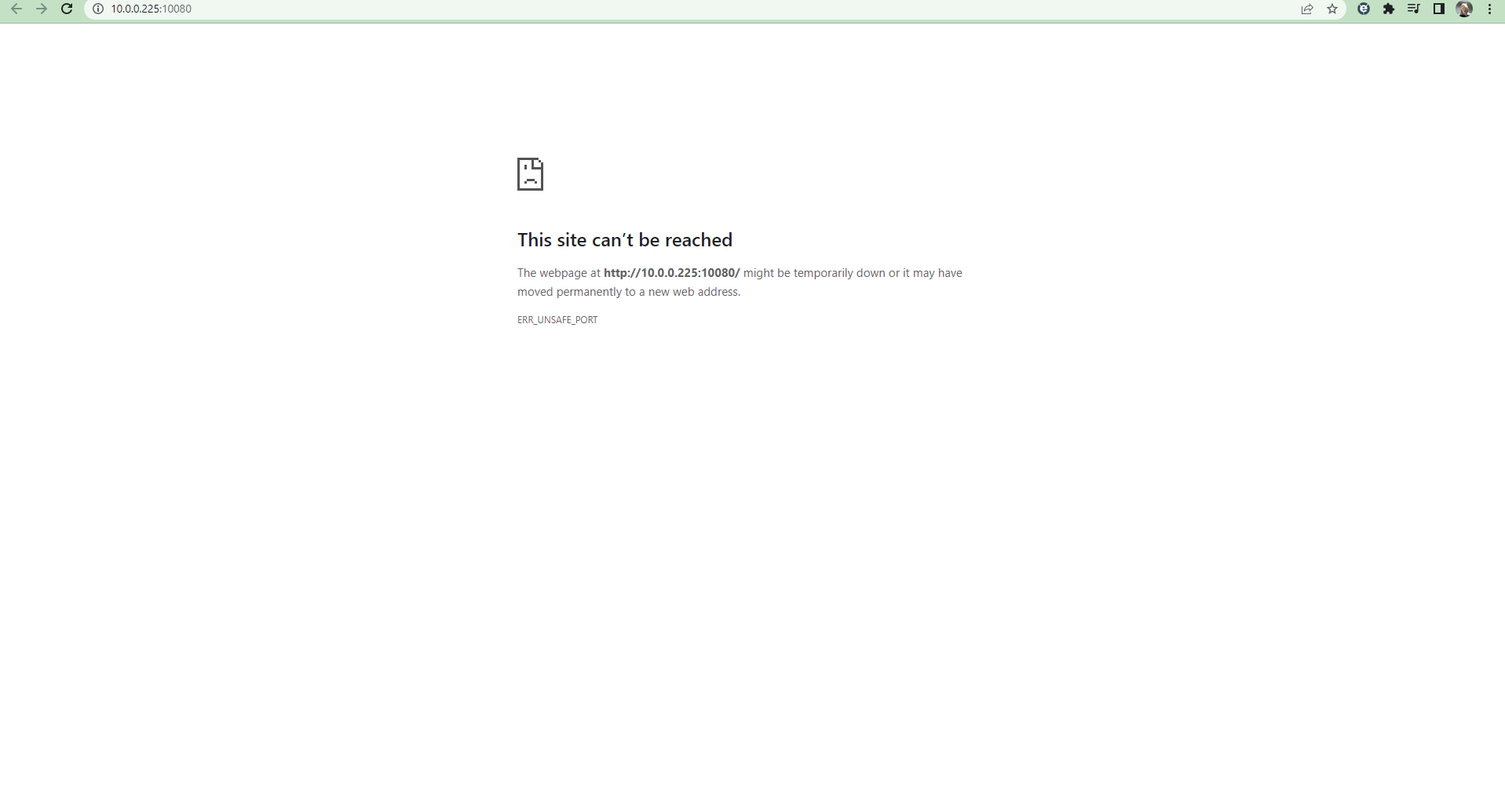

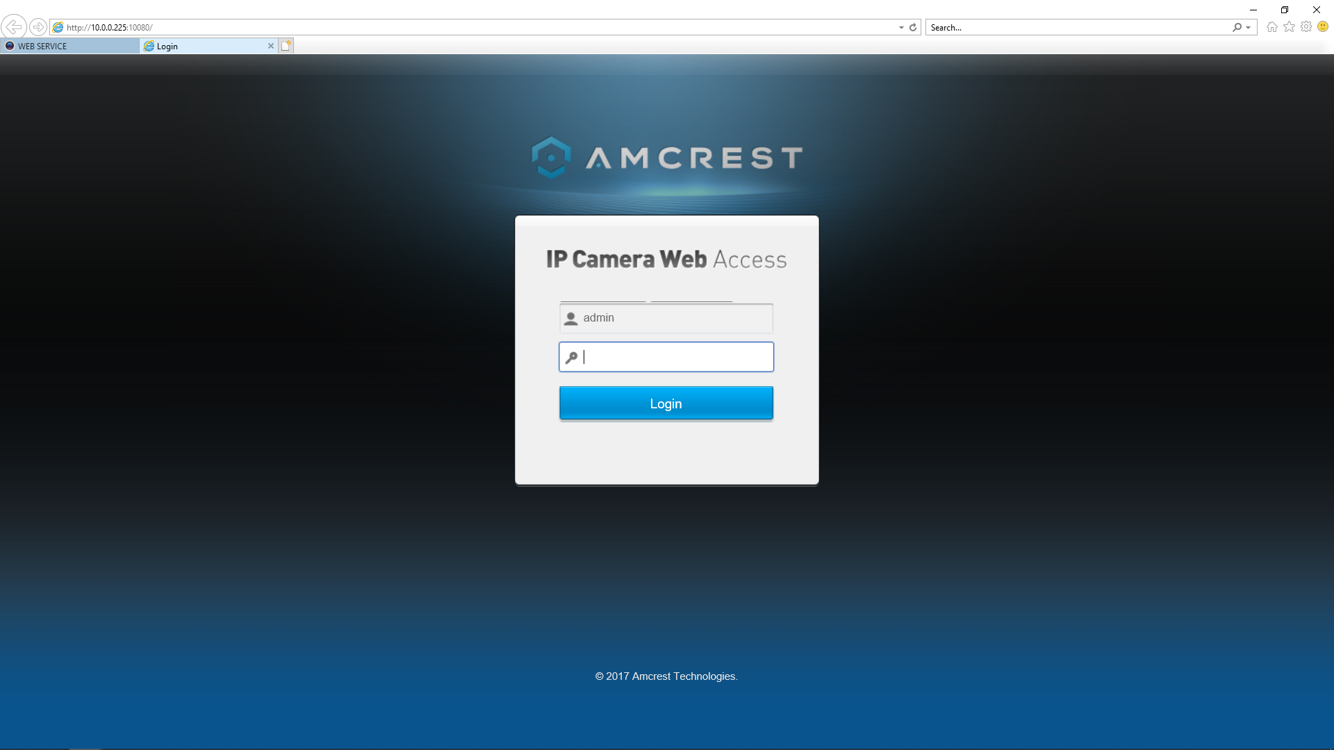

Also if you need to access your cameras 1 at a time without accessing them from removing the camera from the PORT you can connect VIA WebUI of NVR, (If your using Chrome) click on camera you don't want to connect to first in the list, It will bring up that in a new tab and tell you that the port isn't safe. That is ok because now the next camera you click will give you a new port number and you can connect to that camera over that Port. First one for some reason says is bad port of 10080 next one will be 10081 and will work. There is no issue if using IE even on the first 10080 port..
So I am clear, In WebUI (Your IP address of your NVR) after logging in, Click on Management, Camera, then click on the e in the bottom window (Yours might have Chrome seeing it is newer model then mine) either way as I said before if in Chrome click on one you don't want to access first Then click the one you want to access..
Here are 2 pictures one from IE and other using Chrome so you can see what I am talking about..

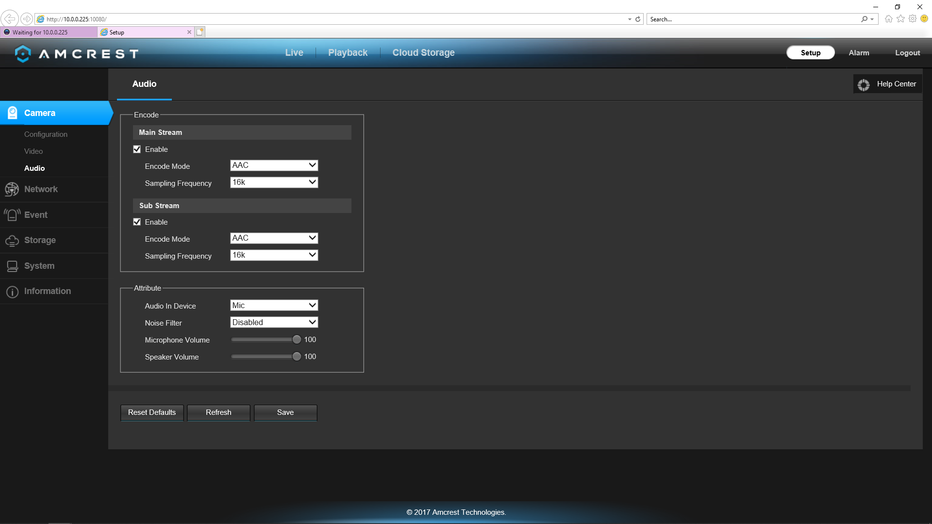

Re: No sound
To make it louder, I would log into your camera as I outlined in the post above. If you still have IE, IT is best used in IE, Then click the camera you want to edit, Then log into the cameras WebUI, From the cameras WebUI, you will want to then click on the Setup, There it should show area for Camera Setup, on the left Configuration, then under that should be Audio. Now for this camera I have it Disabled for the Noise Reduction and I have the Mic and Speaker all the way to 100. This I setup because I want to pick up Audio from a good distance in 360 degree area.
In that area is where you will want to play with settings to meet your needs.

Re: No sound
So here is somethings to try.. Not all cameras work well on the AAC format, So I would double check if maybe it would work better with the 711 format and changing 16k to 8k. Might have to play around with settings to get things to work well.
Also depending on the camera and options. There are some cameras that comes with Mic Built in and Mic Ext, If your camera is like some of mine and are 30 to 40 feet in the air then a Ext mic into the area viewed might be the best option. Also in my Picture above, If you look at yours it should have Noise filter option and turning that off (Disabled) makes it much louder. I have a couple that I have to keep at 50% volume and Enabled or the audio is picking up more then I want to hear lol..

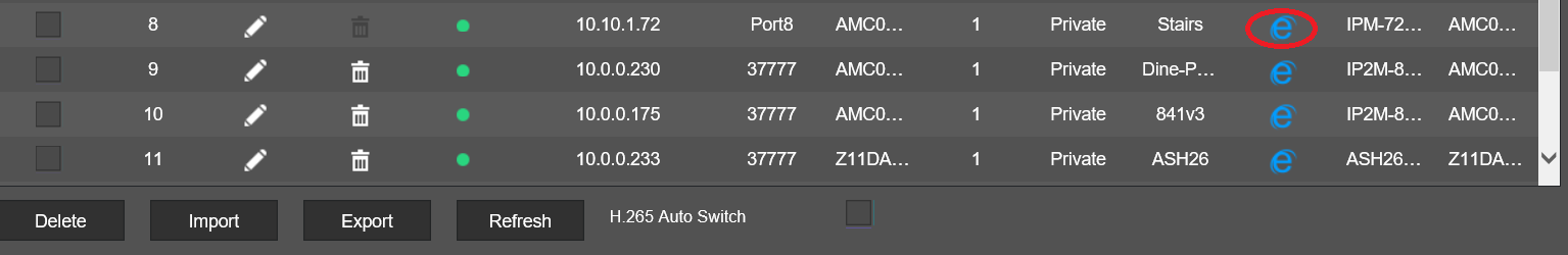

Re: No sound
Going to the NVR's WebUI as I was saying in my post before.. For your case lets say the NVR's IP is 192.168.1.148. When you type that and load the WebUI, You will want to click on the Top left area for Management, Then Camera, then in the remote window at the bottom is where all your connected cameras area, in there is an e or maybe Chrome icon when you click that it will load your camera in a PORT off the NVR's IP address.. You will want to do this if your using Chrome in order like this. Lets say you want to work with Port2 aka Ch2 camera. Click on the icon for the browser on ch1. This will load it in 10080 first and will get a message that the port is unsafe as pictured above.. Then click the one for Ch2 and it will load on the NVR's IP with port 10081 and it will bring up the WebUI for the camera..
However please note that I don't have a A2 and on some of my devices they are turned on and some I have to turn them on if you don't see the E or Chrome area that you can click from your NVR's WebUI. Look in your Network area to see if there is a Box that is empty for Virtual Host if there is a box and no Check mark check it and then log back into the NVR's WebUI and now it should be there...
