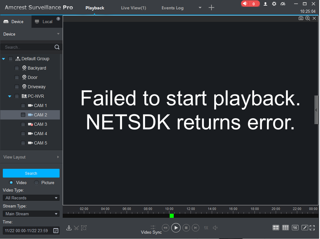

I've setup a PC-NVR and the Surveillance Pro application on my PC but when I try to playback video from the PC-NVR I get this error:
Any ideas on what's wrong? Do I need to install a specific version of the .NET runtime? I'm using Windows 10 (10.0.19041)

Something to try. In your snapshot, go to right middle side of screen and click arrow. Then double cick a file there and see if you get the same result.

Getting this too. Really frustrating when you're trying to review footage and almost everytime there is motion, this error pops up. And don't see any solutions posted anywhere.

In case it helps anyone, I found an old 32 bit windows version of the DAHUA equivalent to the Amcrest Surveillance Pro software that does not give me the same NETSDK error message. It can be downloaded at:
https://dahuawiki.com/images/Files/Soft ... 170724.zip
I did have to run the installer on windows 10 in Windows 7 Compatability mode to get it to install properly.

I had this issue. Live view worked fine, but downloading clips was super slow and sometimes failed. Playback on Windows or the Amcrest app returned the NETSDK error. I checked the network link, no issues. Reformatted the SD card, problem solved immediately.
