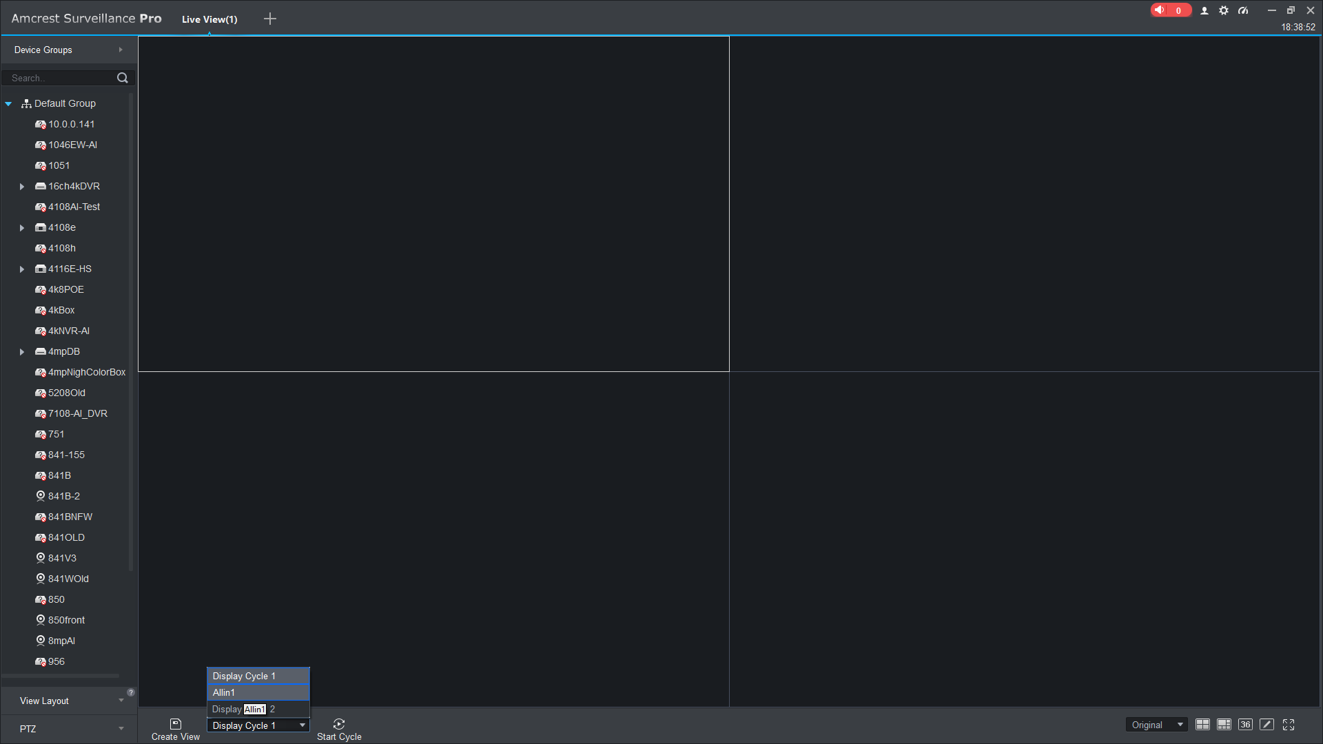

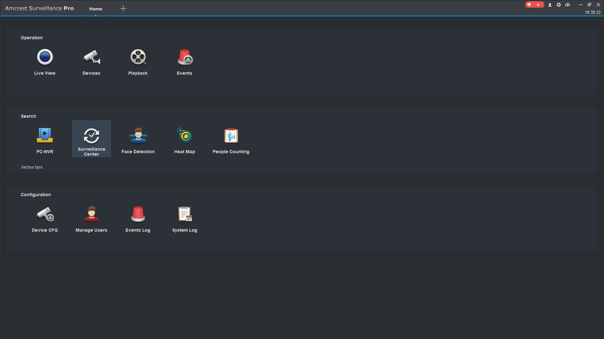

So you will need to setup a Video Wall, (as it used to be called) Now called Surveillance Center, In there you will want to choose the Layout type, You can make a Custom layout if the normal setup one isn't going to work for you.
Click the + to add, Then Click on the Device and then the channels. One of mine I have a Large Layout for 1 camera and the rest are small and another one I have setup to display more then 1 NVR Recorder so I can view everything in 1 go without having to move between them.. Once you have it the way you want, Go to Live view then below choose the one you wanted to playback and click Start on the right and it will load what you setup under that name..

Sorry to hear there is some issues. I am not sure if the way to do it is very well understood and I will admit that I have had issues myself in the past trying to setup Walls.. So I made a fast under 4 min Video of how I setup the wall. Sorry I am little Fast talking as I am trying to get it done as fast as I can to make the Video as Short as I can.. So I went from just the main menu to the setup and while not 100% of all things are shown because of the Recording software Glitch, I did get most of it to show. Only thing that didn't show up was the Main and Sub options but you will or can see it on your side and you get the idea of what I am talking about when the option in the bar goes from Sub to the Main.. Outside of that all other parts show up and I think maybe the Selection of the Wall type might not have shown up either but you can choose from the Normal to anytype that is offered I did a 8 window for sake of fast Video.. Pause and take steps as you need to make your wall. Hope this is found useful
