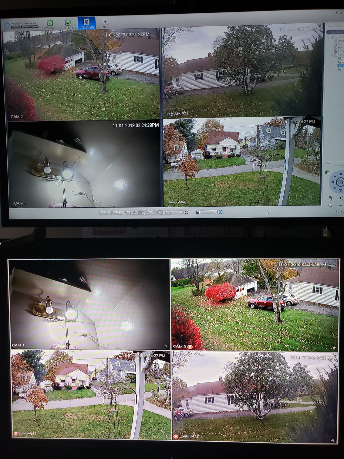

I don't know how many cameras your talking about setting up. I can tell you that working with say My DVR that I have 2 IP cameras connected to when I open it up in ASP I am able to just click on the DVR name and add the 4 cameras by drag and drop. I personally like it because I can change placement of the cameras if I wanted. I have other DVR's that I can do that from page inside but once changed it can mess you up trying to remember what is what chan unless you have them listed lol SO I like the way ASP works because when I close out of it and bring it back up I can choose how it will be displayed.
Here is a Picture of what I mean about change of scene. Top picture is main Monitor bottom is DVR Monitor.
