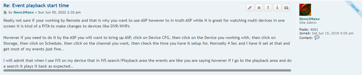

Really not sure if your working by Remote and that is why you want to use ASP however to in truth ASP while it is great for watching multi devices in one screen it is kind of a PITA to make changes to devices like DVR/NVR's
However if you need to do it by the ASP you will want to bring up ASP, click on Device CFG, then click on the Device you working with, then click on Storage, then click on Schedule, then click on the channel you want, then check the time you have it setup for. Normally 4 Sec and I have it set at that and get most of my events just fine..
I will admit that when I use IVS on my device that in IVS search/Playback area the events are like you are saying however if I go to the playback area and do a search it plays it back as expected..
