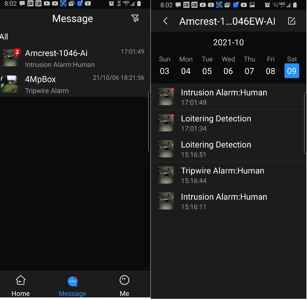

If you like the Ability to know why your getting an alert outside of just motion then, The 4216E-AI is a great NVR, Has many features that not everyone would use. I really wish I was able to use more then 1 type of feature at a time but that is why I have 2 different AI recorders anyway lol. If you happen to live in an area where you might have issues with false alarms and things like that then I would look at getting a AI recorder. You can setup Tripwires, intrusion by default on 2 of the NVR's channels without needing a AI camera. Having a AI camera will just add that many more Channels with AI ability. Also right now I have been playing with some different settings that I normally don't use.. I have them on my 1046EW-AI Camera on Ch8. I have Gathering, Tripwire, Intrusion, and Loitering all setup testing the features being used at 1 time. I have to admit it is a nice camera and features are working great on my 4216E-AI NVR. Again the main thing for me is seeing how well the other features from the camera work over my NVR seeing the NVR only offers the 2 type IVS Tripwire and Intrusion and I will be a-lot more happy as soon as Amcrest updates the Amcrest View Pro to work with the IVS rules..
SO for now I use DMSS to get the alarms and that way i can look at only things that I feel the need. Like maybe at 3pm I don't want a lot of people Loitering and if I got a message of such I know to look and again this would be after getting the Crowd Gathering message. Picture Below is DMSS and the alerts I got today on it with my 1046 AI camera..
