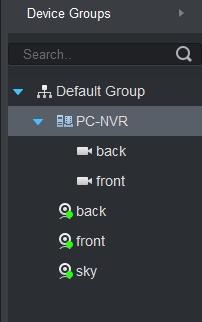

I've got 4 devices on my system. There are 3 cameras and PC-NVR which is also a device.

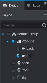

Just to confirm you have added one or more of your cameras to PC-NVR so that when you drop down the PC-NVR tab you can see them listed. My ASP/Live View default group looks like this (note that I don't bother recording one camera as I only use it for snapshots) - In the ASP Playback window it looks very similar. In this screenshot I've selected the "front" camera and I could now go ahead and use the search facility to find recordings. These are completely separate from the recordings on your SD card - If that's what you're already seeing then we need to troubleshoot a bit further

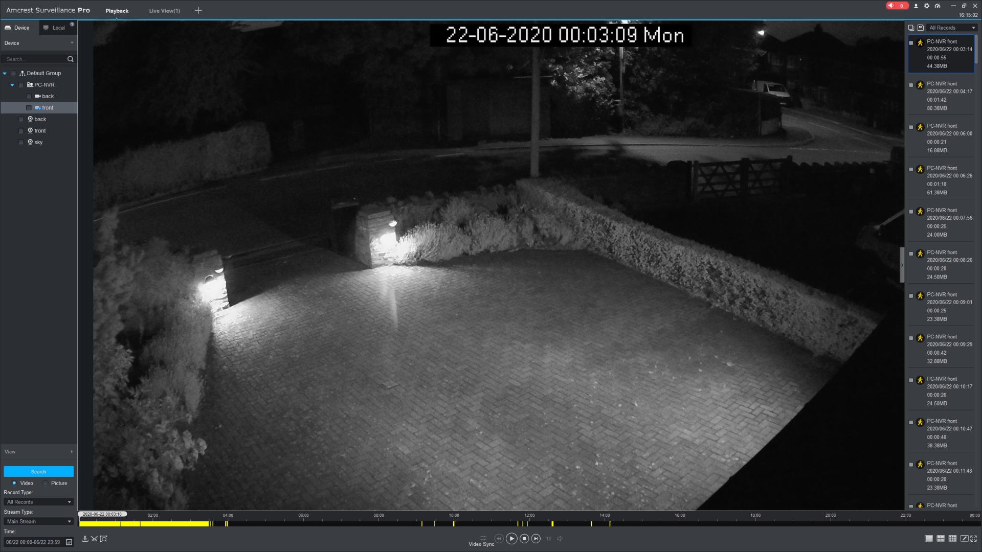

p.s. - this is the first recording from last night on my "front" camera as recorded by PC-NVR and how ASP looks in "Playback" after a search. Note the recordings found listed down right side of screen.

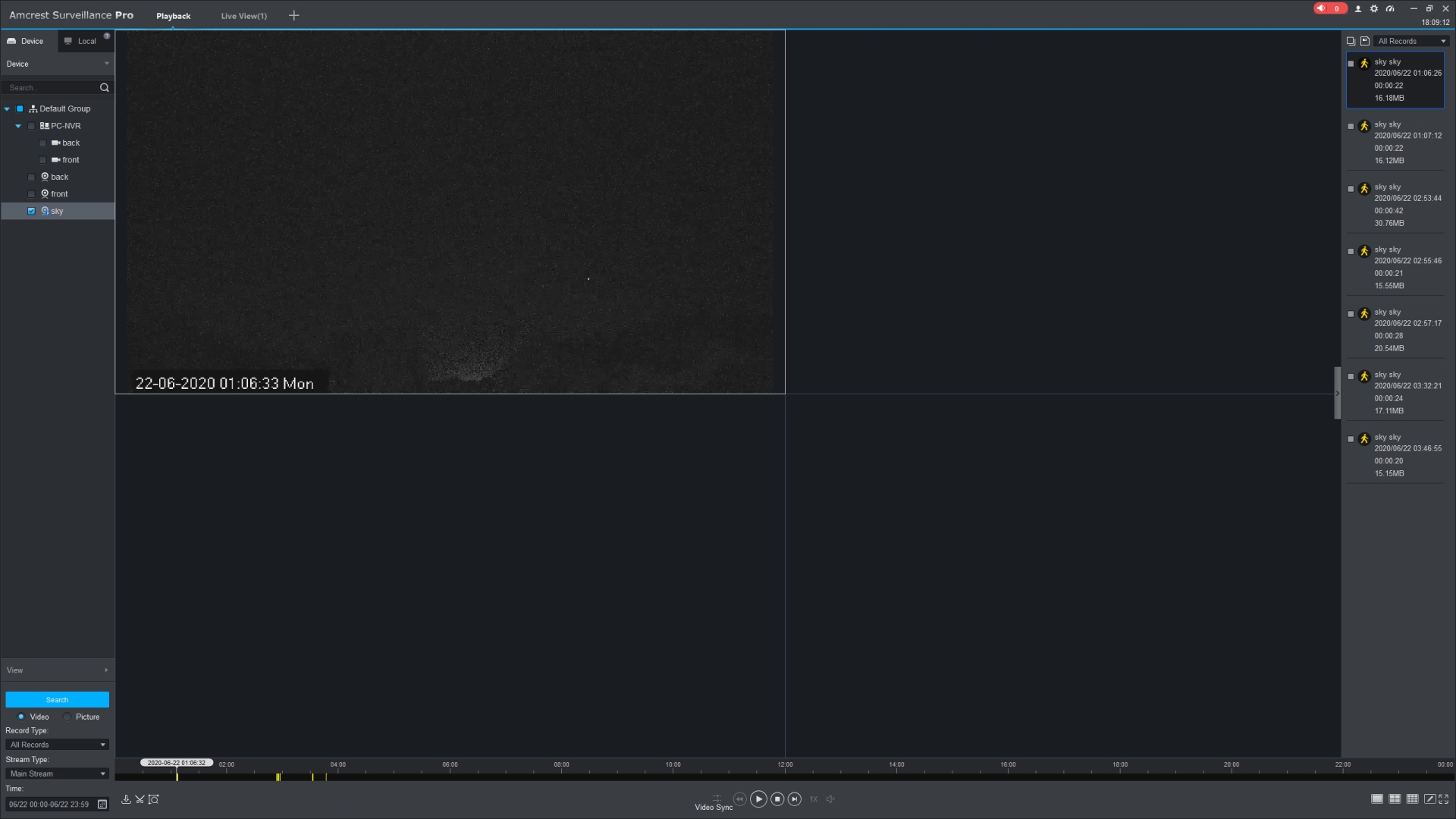

I have to admit that I'm not sure and I'm just guessing. Can you confirm that you are selecting the camera from within the PC-NVR group and not the camera itself. I'm not good at putting things into words and for me a picture is much better. In this screenshot the "sky" camera is selected and a search has shown that there are recordings BUT these are on the camera's SD card, as I said I don't even record to PC-NVR from it. It's an important point to note that the ASP playback view is providing access to both the camera recordings and those on PC-NVR.
I'm probably barking up the wrong tree and telling you something you already know but I found that I got confused at first until I started thinking of PC-NVR as a completely separate device.

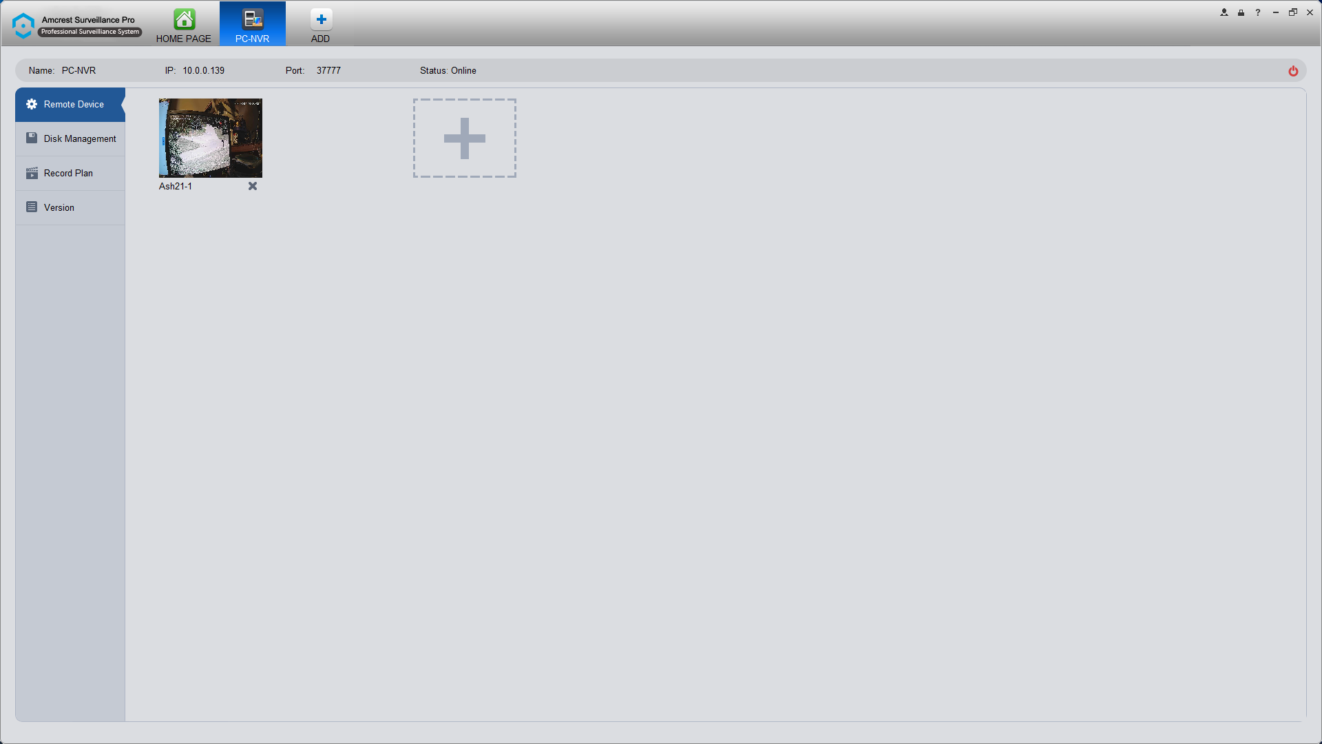

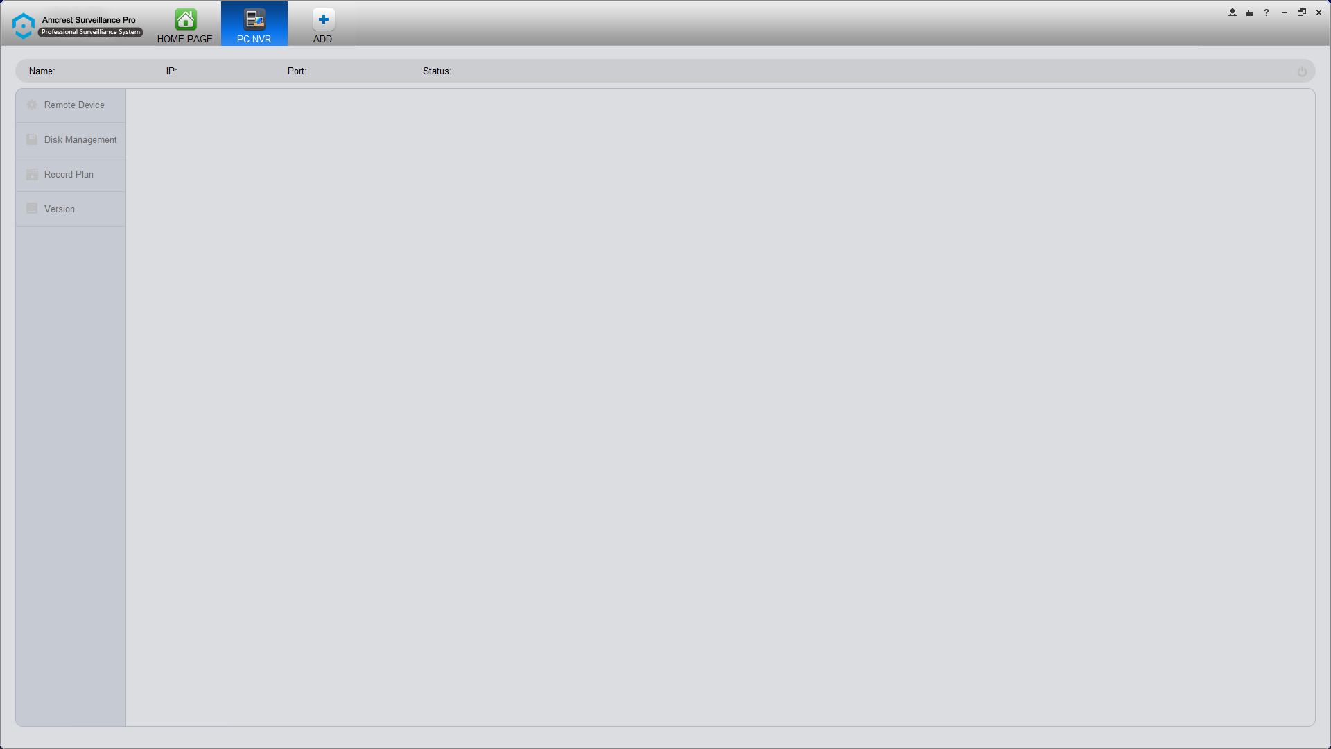

Please load PC-NVR in side of ASP and take a Screen shot of the first page.. IP address don't matter but if there is any SN present please blur them out.. .
This computer don't have PC-NVR because I have to many IP's that is the first Picture I will show.. Please note in the first picture there is no IP and PC-NVR is not in the page.. On Second picture there is that Computers IP of 10.0.0.139 that is Host to my PC-NVR and another FTP server for my Cameras.. This is a Picture of another one of my computers with PC-NVR setup for my Ash21
