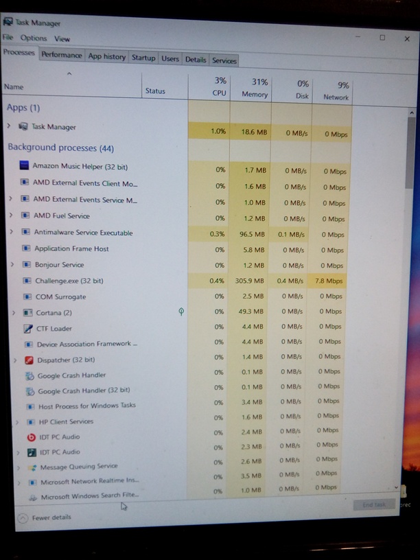

jack7 Test:
I turned on PC-NVR recording 24/7 with two cameras, 2M and 4M, both with 30fps, 4096 bit rate and substream on. PC is 2012 P7-1235 with AMD A8-5500. Here are task manager stats with only PC-NVR on and recording the two cameras:
Total cpu - 3%
task mgr cpu - 1.9%
challenge task cpu - .8% (challenge is the active task that PC-NVR uses to record cameras.)
It appears quite a few cameras could be recorded simultaneously. Obviously if ASP is loaded viewing, replaying, and decoding camera streams, total cpu % would go up while that was going on.

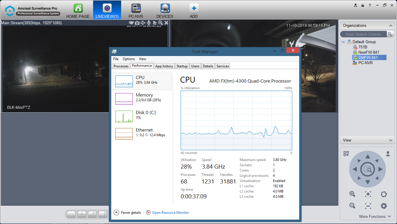

Wow that is Great Stats... I would love to see a Screen shot of them... I have a different computer that I went and turned on for the first time in a while. For some reason right now one of my cameras is not working on it... But I did a Test on this computer.. IT is a AMD-FX4300 and is said to be right on Par with your A8-5500... Doing a Test and looking at Task Manager under Performance Mine isn't getting anywhere near that... Don't mind HDD and all other things missing I turned off everything that it was running because I thought 6 hdd and things might be more then what was running on yours so only 1 HDD running and only loaded ASP, PC-NVR and Chrome and with only 2 Cameras I am running 30% cpu.... Not sure where you are getting your data but you can see my Snap shot here...

So did some more testing and thought ok lets do 6 cameras on my normal daily use PC... It is Nothing special... Intel 3920 running at 2.9mhz, 32gb of ram and a 2gb GPU... This time it was even working little lol...
So for some reason when i first loaded the cameras they all cam in Went to look at Performance next thing I know down to 4 cameras lol the 2 CVI went offline So I was ok.. Doing about 64% cPU lets just say for giggles that someone wanted to use the only computer they had as a ASP PC-NVR... I can tell you that had I had PC-NVR my computer would have crashed with the 4 cameras... However I loaded youtube and started a Music Video. It is some of Avicii dance music. May he Rest in Peace.. Anyway I bring up ASP and now not only the CVI cameras went offline, CPU hitting 100% to 80% and now only running the 3 841's... Memory is doing well at only 4.5gb out of the 32... However CPU is not happy and for some reason the 751 didn't stay loaded either lol....
First Picture is with the 4 IP cameras working after for what ever reason the CVI went offline I tired to wait for them to come back online but they never did... I can load them in the Big Window but they don't want to go in the small one lol... OH well. 4Cameras and Task Manager
Second one is after the system no longer wanted to display my 751 after I loaded youtube playing a music Video
This picture is just same as the one before however went from being there unknown to now being offline lol...
The last picture if it will let me load. This is just showing that while PC-NVR is online and Green when I try to load it nothing comes up. Also shows this is WITH OUT IT running and if it was to record yeah don't think this computer would be able to do it...

jack7
Posts: 904
Re: ASP - Unable to add cameras
Post by jack7 »
Revo2Maxx,
Here's a PC task manager snapshot that supports my earlier post. PC-NVR is recording mainstream constantly for the two cams. I can replay them when ASP is loaded. There are some more task manager pages with a few miscellaneous Microsoft processes using CPU. These stats are approximate and vary a little over time.
I forgot to mention that I use ASP 2 Beta (code name SmartPSS 2.02) which uses PC_NVR 3.0. The announcement of ASP 2 Beta and it's forum thread were deleted recently by Amcrest. So you can no longer download it from Amcrest.
That Says nothing about ASP running or PC-NVR as you said you were running at such LOW value lol... That says there is nothing running on your computer how does that help... 31% ram?
Then you said you had PC-NVR that would have Disk % yours is 0 and Network 9% sorry not streaming 2 cameras and Encoding them....
That Proves nothing.... mine shows Real world NO BS USE your PICTURE Clearly SHOWS 1 App that is Task Manager...
Not sure what your trying to prove with that... ASP is an APP would be loaded there.... Also not even in your list as it is Amcrest it would be high up under A Sorry don't know what your trying to SHOW?????
