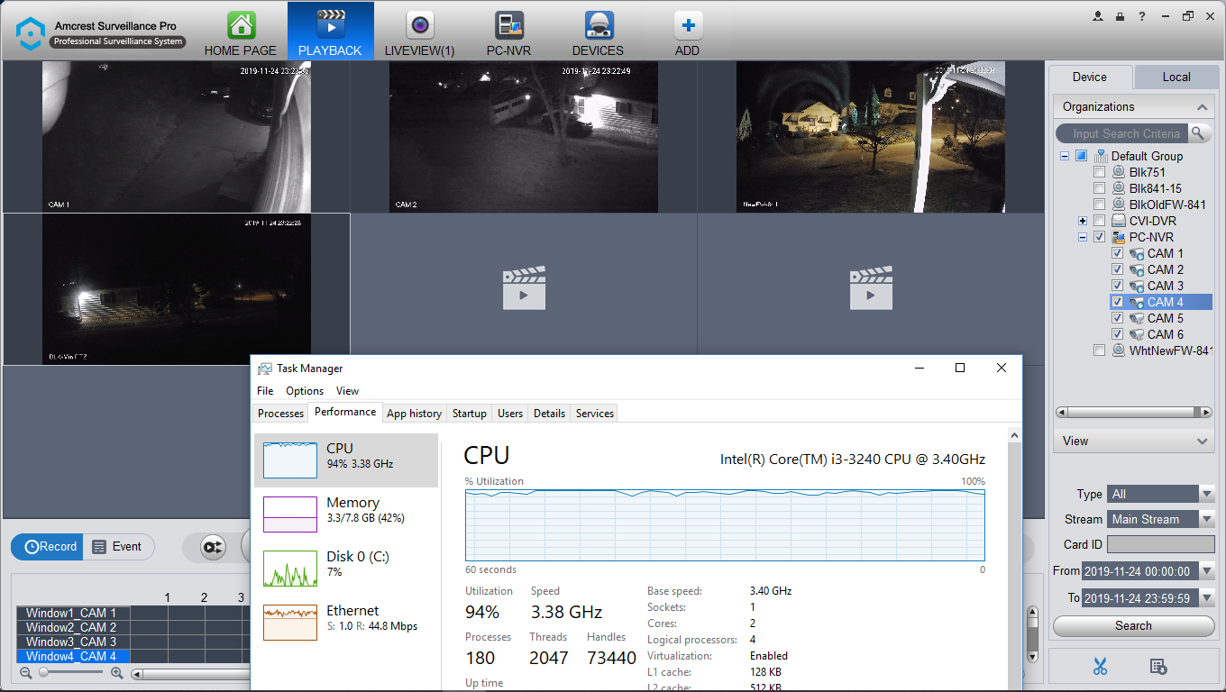

PC is a i3 3240 with 8gb Ram and 1tb WD HDD...
ASP setup all cameras as stated. I brought in all the IP cameras first... 195, 215,218 and 219. Then I added the CVI dvr that already had the 218 and 219 on it but wanted both in for testing...
Started PC-NVR, adding to to my Static IP i3 computer ip 139.
Started PC-NVR to auto load on Reboots...
Right Clicked the CVI group on the right and clicked on Load Main checked all the cameras that listed and added them.
Then I added the 215 (841 2015)
Then added the 751
Rebooted computer.
Loaded CVI camera set by choosing Main Stream 4 screens pop up I change to 9 and they stay on Main Steam then I add the 215 and the 195 to have 6 streaming live feeds... Ctrl, Alt Delete and check the performance and doing well at a 48% to 53% moving between cameras and such kept thing under 60%. I then loaded the Playback off the PC-NVR and adding cameas as you have to or only way i knew how 1 at a time went from 75% to a 100% on all IP cameras loaded in a 9 window setup was going to bring in Cam1 and 2 but with the Live View active it didn't want to laod.. SO I pressed the X of the Live View and with all 6 cameras in playback they were playing but wouldn't sync.. and with all 6 camera in playback only it was going from 92 to 100% but was able to switch and look over things without lag...
So in the End... I wanted to also look at the Flow with just PC-NVR running and ASP off after a reboot... So shut down and rebooted computer... PC-NVR loads on reload and starts Recording the Camera as you had them setup... I then CTRL alt and Del again and checked performance was at 19% CPU for total... however looking at PC-NVR there was nothing on CPU tax only HDD and memory didn't think about the % of network as I wasn't looking at that lol... Under normal testing with ASP running and live view it was 44 to 50megs
I would use this computer without issue to record ip cameras if I didn't have another way of Recording already... I can tell you this will mess up the Time of the cameras I don't know why but all of them get all crazy on the times lol.... When I looked back at Live view after Playback the Time was off 10min from computer time...
So if you were going to say run 1 or 2 on Playback at a time then I would say this would be great... Trying to bring them in all at same time... Then use a Game Machine lol However for a computer just chilling in the closet and need something to record in a pinch.. I would use this and even the 4300Fx that I did testing on just don't try and play back to much or Live view to much not that you only want to look over 4 of your 8 or what not but go by what your computer can take...
Only going to load 1 Picture that is off the I3 This is just of the 4 off the CVI system loaded not doing other 2 IP camera for this picture wanted to show test much higher then newer Game Machine tested using the 4 IP cameras this only 2 1080 and 2 720P

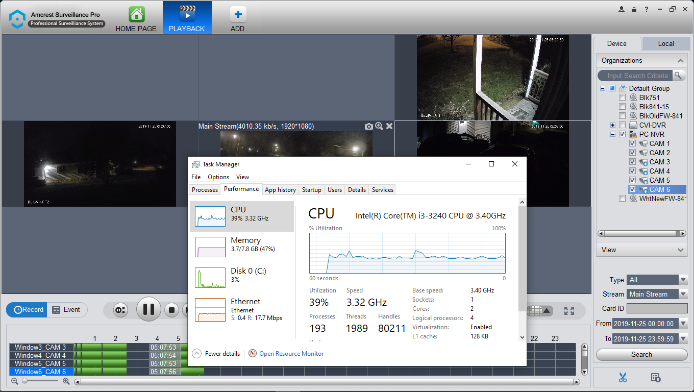

This is an update of play 4 of the 6 seeing there was no motion on the 2 720 cameras to play back...

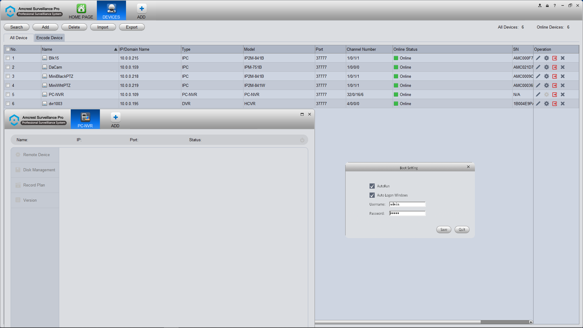

Thanks I was kind of thinking the same thing... I am not sure how I could find the Conflict... However i did have the IcRealtime PSS with the PC-NVR on another computer running... About a week ago I thought kind of same thing... It was V3 and thought maybe after I uninstalled it on the 2018 PC that it left some things behind.. So last week Un installed it on that computer and Installed Fresh Install of ASP with PC-NVR and it went up without any hitch... Able to install PC-NVR, Get the cameras all loaded in there no problem... So I then thought Lets un install this computer again the 2018 one, Rebooted computer even though I didn't on the other one I thought maybe there was something staying over on this... It is WIN 10 Pro where other is Win 10 Home... However after all things reinstalled and all cameras installed in Devices, Installed PC-NVR. Went and setup the PC-NVR with pass to auto start and boot like I did the last one... Rebooted the Computer There it was running in background ok... So I went to add the cameras like I have in all my other testing... Bring up ASP, Click on PC-NVR and it just CHILLS on the page never giving me the + to add. SO I even thought lets try and force add lol... NO Just never gives it to me...
SO I thought oK for kicks and Giggles lol... Un installed it again. This time Installing the IcRealtime PSS v3... Loaded all the cameras, loaded PC-NVR did everything just as I did before ^^^^... After reboot, started software, clicked on PC-NVR and within a Couple of Seconds it loaded with the area to add HDD space and the +. Added cameras did a hour run... Played them all back to double check no issues... Then i was like OK heaven knows I am starting to Enjoy this LOL NOT.... So uninstalled it.. Clearing as stated all data... Reboot computer.... played a game or 2... Came back installed ASP again... did everything as stated above again... And again ASP shows PC-NVR is online with Green dot but will not let anything go in.... So yeah I am at a loss lol.... I am about to think about trying something else lol I wonder what would happen if I try to pull in a different PC-NVR on a different computer lol hummm ... I have a few to try lol...

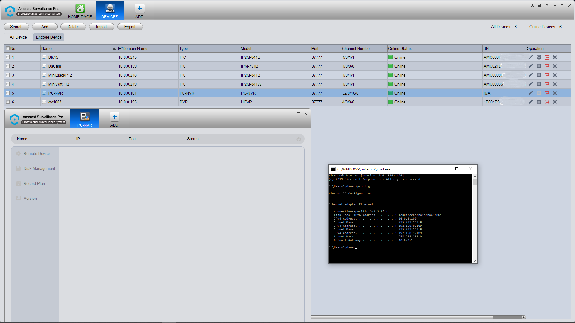

Yeah sadly there is an issue with my computer something in it has blocked it and don't know where to look.. I even tried one that is working... I was able to load it and get a Green light saying it was online... Still no go... you can see bigger image right click and pick open image in new tab... Just showing that PC-NVR is loaded online but not on my computer as you can see from ipconfig set of IPs for this computer...
Also before it is thought maybe IP issue even with it online it can't connect because of the Multi IPs that isn't the case because I did take out the other 2 Ips for only my 10.0.0.109 in other testing thinking that might be issue.....

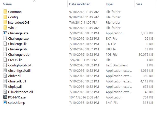

On your PC that doesn't work, check and see what's in your PC-NVR folder and see if it has the same files and file sizes as the ones I show below for ASP V1.
Also if after reboot, you have some autostartup procedure set up for PC-NVR that loads it before you start up ASP, check to see if it is starting the right PC-NVR.exe in the right location.
ASP V1.14.1.R.20161018
Re: ASP and PC-NVR your only means of Recording...
Yes and dated as much the same besides the Win32 that is 529 so I am guessing that don't get deleted when I uninstall and that from first time I installed it.. Also I see there is some Partial files under SmarttRSS folder as well.. So i wll uninstall and delete all old files in that folder as well as the other HDD that I iunstalled it in as well lol try again. TY for the Folder info

So did some more testing today and at first I thought I found something that might matter to some... Then maybe I didn't find anything at all..However looking at the data from before I found that working on the 9 smaller windows had low good numbers for Performance... I Put same set in the 6 window setup where 1 is larger then the others and while at first I thought it did jump looking over it some time after I seen the 3 to 5% higher over all I don't think will matter much... So good news is once all is setup and set to Record with ASP off and mind you all the testing I did in the past was only with ASP running and blah blah lol... I can say that without ASP running the CPU load is very little. I have yet to do any other testing like normal web and or youtube videos as of yet... HOwever here are Today's finding.
This last picture is right after closing ASP and only thing running at the time was PC-NVR and what ever else may have been running in the Background...
