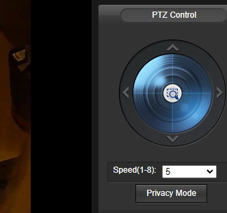

They are looking for the ability to turn off the camera aka put it to sleep
Screenshot (2691).png (55.2 KiB) Viewed 4346 times

Revo2Maxx wrote: ↑Fri Jul 22, 2022 10:09 pm They are looking for the ability to turn off the camera aka put it to sleep
Exactly! There is no "Privacy Mode" button on the PTZ controls in ASP like I'd expect.

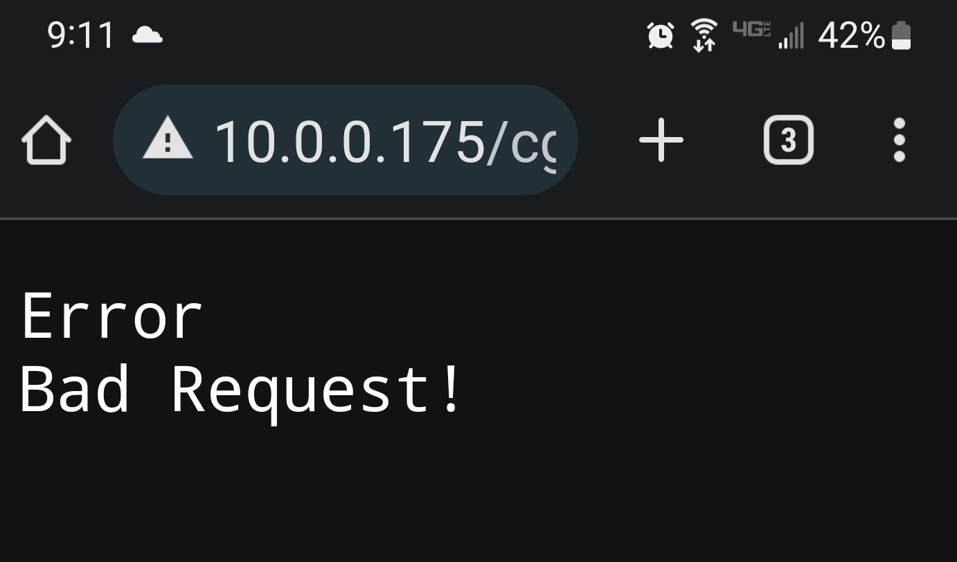

Thanks I did try the command remote tunnel to my v3 it failed when I get home I will try again local
Thanks @jack7 for some insight as the post said its undocumented info so need some more testing if I find working cgi I will post it

Ok got it to work again Thanks @jack7 for the help with the matter
To turn off the camera use
10.0.0.175/cgi-bin/configManager.cgi?action=setConfig&LeLensMask[0].Enable=true
turn it on
10.0.0.175/cgi-bin/configManager.cgi?action=setConfig&LeLensMask[0].Enable=false
using http and the rest before using your IP address
also running this will give you all the data for the state
10.0.0.175/cgi-bin/configManager.cgi?action=getConfig&name=LeLensMask
