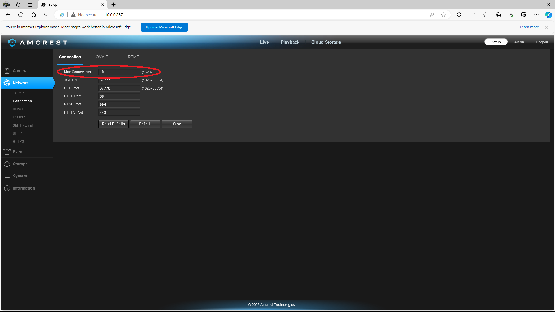

I would look at the Cameras WebUI and make sure that the Max Connections was not reduced to a number to low for your current needs..
Meaning if you have DVR/NVR that it connects to and ASP, AVP and your computer, maybe a couple of family members or friends have access you will want to make sure not to lower that Max connection to low. Some cameras come setup with 120 some 30 if you were to lower it to 3 and have NVR, ASP and you then was working in WebUI. However wanted to look at the camera and bring up AVP you would be maxed out on the connections.

I recently installed one and I am having the same issue "Exceeded Maximum Connections" error and after that I cannot access it until disconnecting it from A/C. I can only access the camera through the AMCrest Cloud but not directly (via IP) nor the "AMCrest View Pro" app. Firmare is up-to-date.
I checked the Network "Max Connections (1~20)", I have changed it from 10 up to 20, and same error.

Not sure I understand how changing your IP would make it any different to a Max Connection error. That error is based on what someone sets up in the camera or DVR/NVR connection status. This normally to help reduce people from making bad connections to your device. Like changing a IP camera from 10 to 4 if you have it setup to work with a NVR, ASP/AVP and have maybe a family member that would connect with WebUI or another app then that would be 4 connections so anyone trying to hack that connection wouldn't be able to unless all other connections to the camera were not currently online.

@Revo2Maxx yes I did change that setting to the max (20) and was having the same issue (i only have 3 devices connected my nvr and 2 phones). I even factory reset the camera to default and would get the same error. It was not until I manually changed the ip I was able to rid of the error. I'm just as confused as you are on why it worked but it did im not a networking expert but glad its working lol although I will add none of my cameras were ever on amcrest cloud
