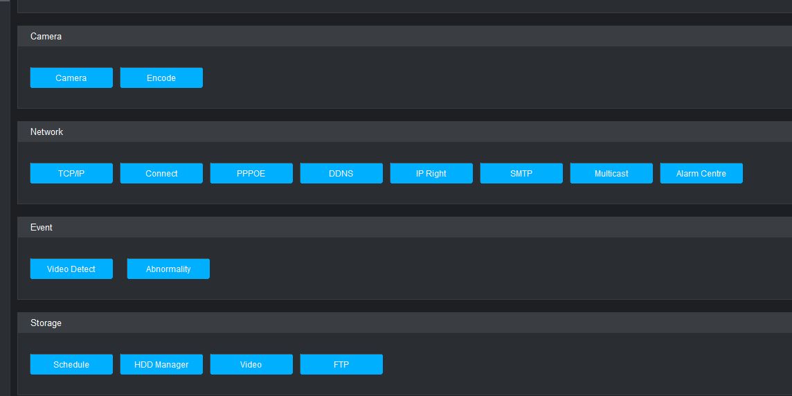

After a while (~5 months of usage) Amcrest surveillance pro stuck whenever I try to open app settings. (Gear at top right corner. ) so I have to kill process and run app again.
Also I can't change configuration for the cameras and NVRs. 'Camera' and 'Encoding' and 'Network" buttons are not working. simply doing nothing on click. Basically every button isn't working (as at attached pic)

I would double check that you have your system logged into the Admin account and try again. If it is Then I would log into the NVR and do a Reset of your NVR maybe.
First I would double check that your logged in the right account. If your on a different admin account I would double check that you have access to that menu.
I just looked at mine and I can click on the gear and access all items in the menu even did a Backup at the bottom of the page.

Account is right one. I have multiple NVRs and stand alone cameras . Not accessible for configuration.
I can I access them all from another machine with ASP installed, (test one) .
Looks like there is problem with this particular ASP installed at main machine. No changes were made since it was deployed few months ago. Neither to Windows OS not to ASP itself. It simply stopped responding however there are no problem with Live View, PC-NVR, Playback and so on.
I'm facing problems with Devices/Device CFG tabs and ASF Settings only. I can add new devices no problem but when it comes to configure it I get issues.

Oleg, you wrote:
"I would love to uninstall and perform clean install but I can't perform the backup due to first problem with settings button."
You could try saving your last backup files and then restore them after after an uninstall and clean install on your main PC. Or if your other PC that works OK has an up-to-date config, then do a backup there and use the backup files on your main PC after clean install.
