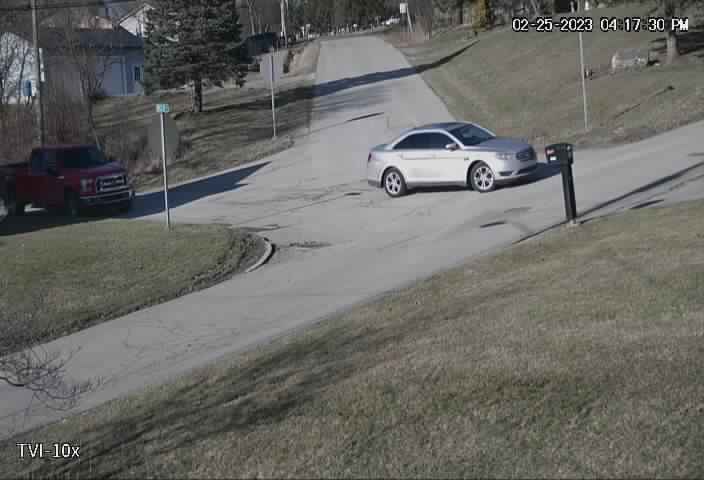

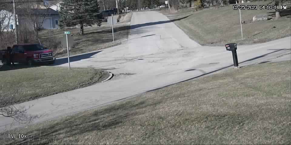

So a couple of things to remember when it comes to the DVR over an NVR. by default it will setup the DVR for the smaller images for the fastest connection to a Mobile Device. I personally don't like that so in the Snapshot page setup I change the format of the image to be 960h in size rather then 352x240 aka CIF. However keep in mind that the 960h is pulled wide and might be better using the VGA setting of 704x480. The 960h format is 960x480 so what ever one works for you
Keep in mind that you will want to change the format type on the right area. When you bring up the page it will default on Scheduled. click that and choose event. Then make the change there.. Here are 2 pictures that was sent to the FTP one the wider one is 960h format and the smaller is 704x480 and that is D1 normal..
