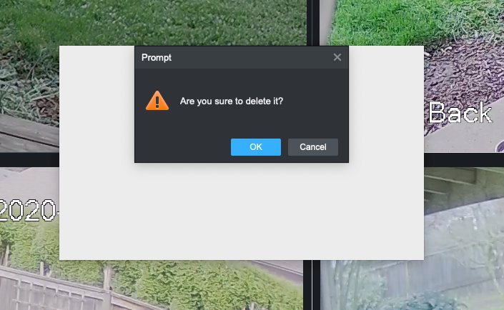

Also, if I set a PTZ preset, then delete it, a small blank window appear in the middle of the screen, behind the prompt: After I close the prompt, the window remains. I can bring the main window forward, and I can select either window, but the small window can't be moved. It only goes away when I quit the program.
