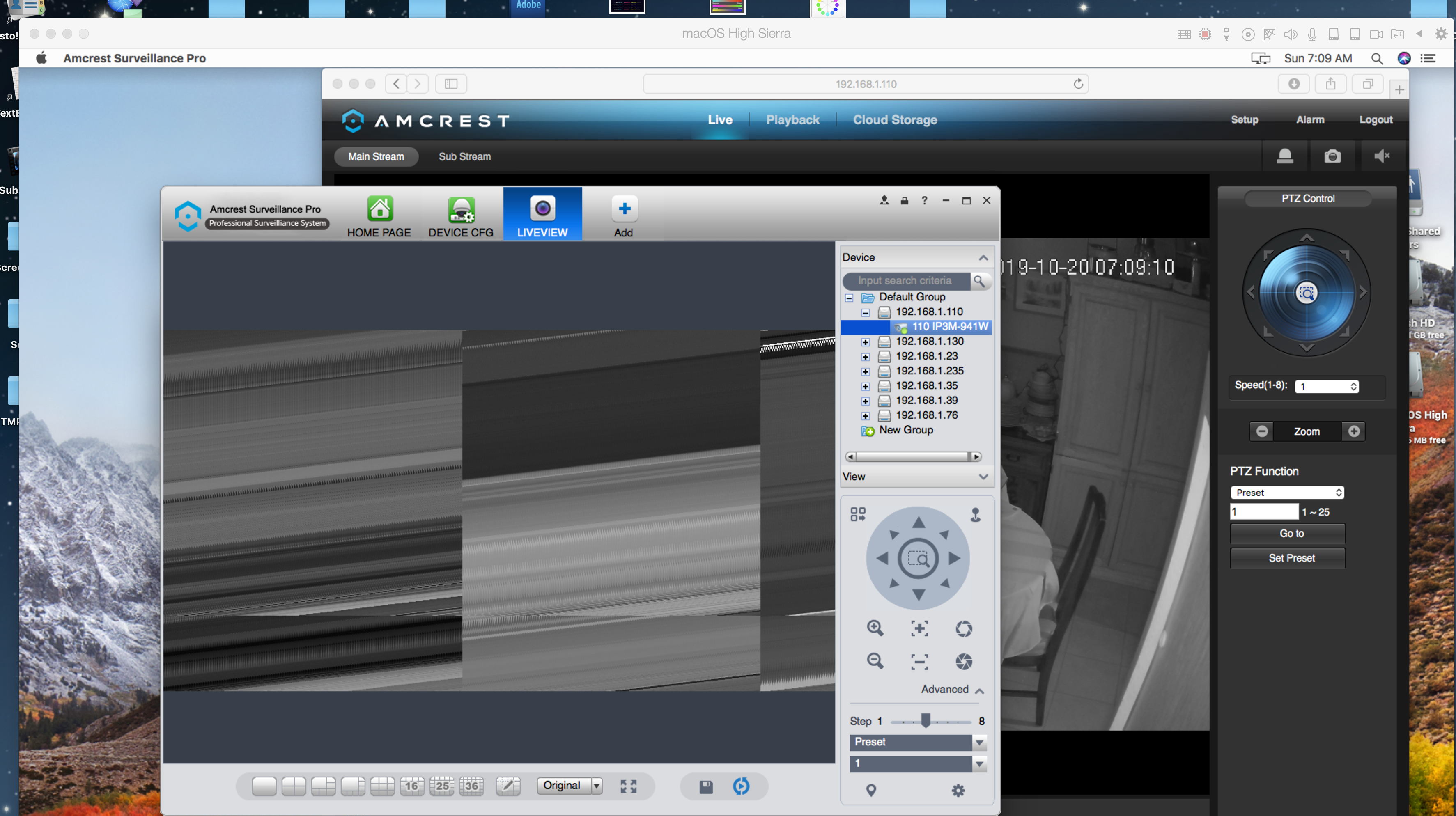

Thanks for the response. I had already tried all settings for the display resolution. It didn't matter what resolution I tried the image within the installation window was exactly the same. It should be noted the ifconfig installation went perfectly on the Windows VM.
I'll also add the ASP is the *only* application I have video problems with.
I decided to try installing High Sierra in a Parallels VM.
I ended up with another problem with ASP--*almost* everything works as it does in my normal system. The only difference, and it makes ASP unusable, is the display is scrambled as if it was out of sync.
I tried using the VM Safari to access the camera and the video is normal. To say the least this hasn't improved my feelings toward the 32 bit ASP.
- Screen 2019-10-20 at 7.09.15 AM.png (4.49 MiB) Viewed 3279 times
