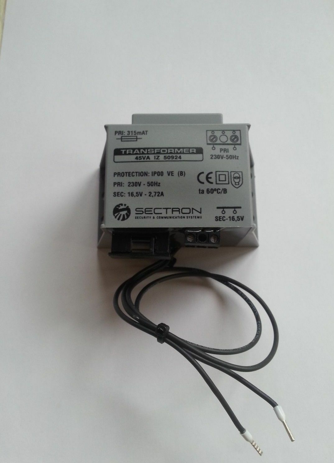

Post by aristosv »
I am assuming this will work?
Re: which chime or transformer to buy?
Yes that is good 2.727272 amp so it should be good enough to power without issue... However I did find one that was marked 16.5vac that didn't have any power over 16.5vac so the power drop could be more then others out there I would test it for Voltage and see if it gives you first something like 18vac to start with if only 16.5 then it might be over distance the drop might be more then what could make the camera work so keep that in mind as well...
