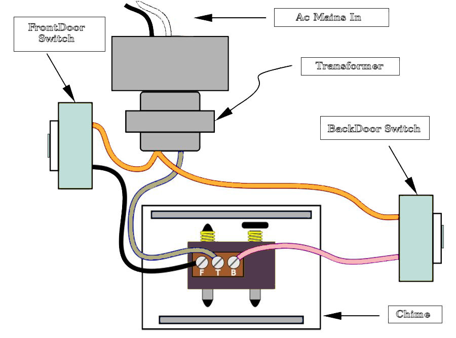

So people understand my statements. When a Doorbell is connected to the Bell system in the house it is at a stand by state.. It isn't until you press the button at the front of the house or back of the house that the Power flows to the Bell system This is a VERY SHORT TIME... However when you put something in line that now makes that Transformer live and loaded at all times the system now has a load on the Transformer. Alot of time people don't even use the right Bell wire and the system is running a load over the wires constant now...
I have provided a Image for an idea.. This shows front and back switches installed however you can see in this there is no direct power until one of the buttons is pushed...

Sorry I wrote this and was making image when you 2 posted...
It sounds like the 2 wires you are connecting is not the right ones...
As my Picture above a DoorBell switch is an open Circuit if you will When you push the switch it lets the current flow to the Doorbell... If you connect the 2 wires and the door chimes like it has the buttons pushed then there might be an issue with your Switch wires...

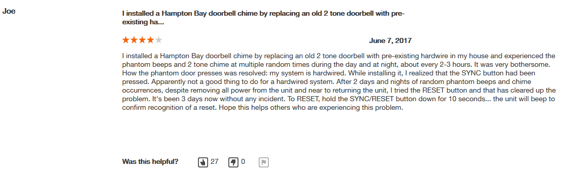

the chime kit serves as a load resistor to the chime. unlike a push button that is wired in the open position, a smart doorbell is wired in the closed position so there is constant power to operate the doorbell camera. the chime kit provides load resistance between the doorbell camera and the chime so the chime does not go off in a closed circuit unless the doorbell camera sends a signal to the chime kit to allow more current flow to trigger the chime. digital chimes may still go off from false triggers in the circuit even with the chime kit installed hence many digital chimes have a reset function for stopping false triggers. the hampton bay HB-7612-02 has a reset function to stop false triggers. digital chimes are also susceptible to false triggers even with a regular push button doorbell in a hard wired setting. here's one comment from a hampton bay HB-7612-02 owner.
hampton_bay_HB-7612-02 .PNG (33.01 KiB) Viewed 6754 times
