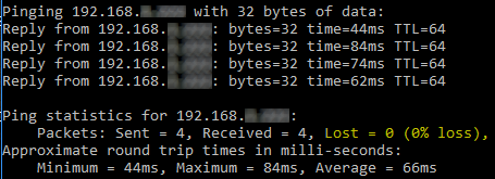

sounds like you may have a network issue. what do you get when you ping your doorbell?
on your command prompt, enter the following:
Code: Select all
ping <ad110's ip address>
you should see something like this. pay attention to the packet loss. keep pinging the doorbell to get an idea if your doorbell is struggling to stay connected to your wireless network.

Nope No Network issue. during the day and when not streaming HD at night there is no loss of conenction. This is only an issue at night when the IR is on and i am streaming HD. I have tested the wifi at the spot and its fine. Its like the whole doorbell reboots when IR is on and HD is streaming at night. Like the power is not enough.
